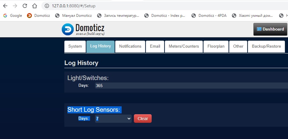

Hello to all members of the forum. I am a newbie user from Ukraine, although I have been using Domoticz for almost six months at the level of setting - searching for solutions.
Now I have the latest version of the program on my Windows server, the head unit is Xiaomi Hub 2 and so far there are 22 temperature and humidity sensors. I am trying to log the temperature in the warehouse with an interval of 5 minutes. I ask because it may be necessary to look at the logs 4 months ago or 25 days ago ...
I have already tried everything, I can not find a solution to increase the logging of sensors - maybe you can add it to me. There is a value from 1 to 7 days. I need more - 365 or even 500 or 1000. How can this be done without using specific programs like C ++ to change program files. If it is impossible to change a file with logging intervals without using such programs, then who can change and share the file with such data with me? :!: It is interesting to log with a 5-minute interval! Since I'm using a PC, the file size doesn't matter. Thanks a lot for the answers!!!

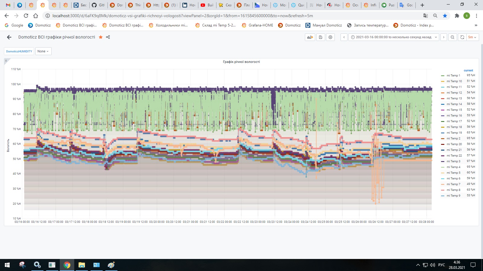

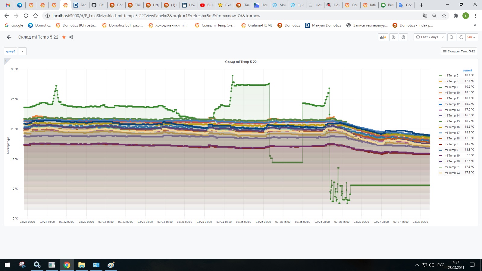

Thanks to everyone who answered me! And I apologize for not writing for a long time - I was busy with work and some hack ...
I decided to take advantage of the kiddigital advice and started installing Influx and Grafana. Played with them for a long time since I am not a programmer, but I did it! Used the following installation manuals - https://devconnected.com/how-to-install ... s-in-2019/ (but the InfluxDB service was not installed by autorun via NSSM, so I just copied it to Start-all autorun programs and now it starts, though not in the background ...)
Then I installed Grafana and then for another 3-4 days I compiled it all into a heap. Setting it all up somehow like this - https://grafana.com/docs/grafana/latest ... ata-source.
In an intermediate version, I used the article - viewtopic.php?f=21&t=35101&p=270521#p270521, but I was not satisfied with the data recording interval - all the same 7 days with overwriting the time exactly 7 days ago.
In the end, I came to the result that I wanted to have !!! Now my Domoticz database through Influx DB and Grafana is collected in tables and graphs + stored for a long time (as far as the computer allows). I attach a photo of the result below + learned how to make backups in Grafana so that you can restore everything!
The essence of my answer - who wants to find - will find, if he looks well !!! You can do it, read it - do it. But, of course, it would be nice if this was implemented in the program itself. On the other hand, I understand Waaren and thank you for such a good product-constructor Domoticz!
