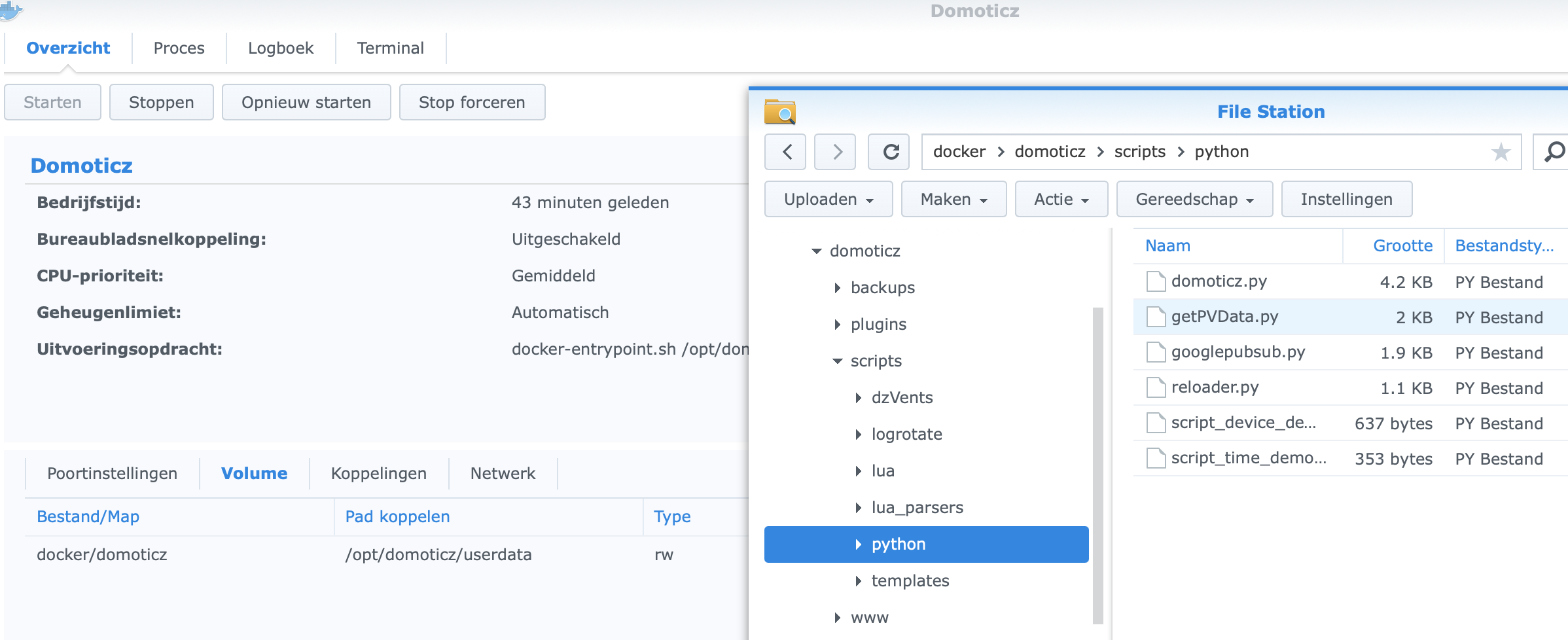

Alcloud wrote: Tuesday 23 February 2021 0:21 You should put your scripts folder into userdata folder.
This is where it gets strange, because as far as I can tell this is inside the userdata folder.
The scripts are in:
volume1/docker/domoticz/scripts/python/
and I connected the following volumes inside my docker container:
/opt/domoticz/userdata to docker/domoticz/
All other folders, documents (like db) are visible in the connected folder.
And when I edit a DzVent script in Domoticz Interface and save that, I see the change when I go to volume1/docker/domoticz/scripts/dzvents/generated_scripts/[scriptname].lua. So the connection between Domoticz and the folder in File Station is there.
So as far a I can tell it is all in the right place.
Schermafbeelding 2021-02-23 om 08.24.41.png (311.36 KiB) Viewed 9893 times
And yes, I know that I do not have Domoticz running with docker-compose.yml.
I have one container running with docker-compose and this container running with settings from the GUI, both have exactly the same behaviour when it comes to this.
