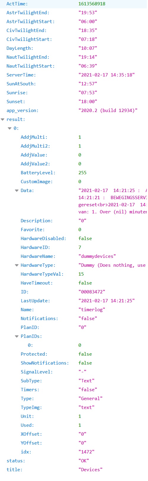

pvklink wrote: Wednesday 17 February 2021 14:01 I have a test device which receives a lot of content.
What is the deviceType / devicesubType ?
pvklink
Posts: 822
Joined: Wednesday 12 November 2014 15:01
Domoticz version: latest b
Re: domoticz api/json url
Post by pvklink »
text

pvklink wrote: Wednesday 17 February 2021 14:37 text
As found on the API / JSON wiki page It should work with
http://<IP:PORT>/json.htm?idx=<IDX>&type=command&param=clearlightlog
Post by pvklink »
yessss, it works!
