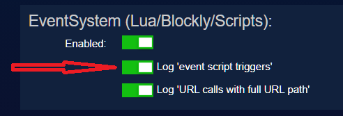

so, is it true that a script runs, but doesn't show its name in log if it makes no change in vars or outputs?
Re: which script type? how function?
abdolhamednik wrote: Wednesday 17 February 2021 7:51 so, is it true that a script runs, but doesn't show its name in log if it makes no change in vars or outputs?
Almost.
the message "EventSystem: Script event triggered: <path/nameOfScript>" will be send to the log if the setting for
log 'event script triggers' ( via [setup][settings][other] ) is set like
AND
there is something in the commandArray table.
