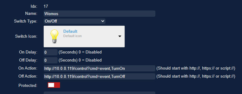

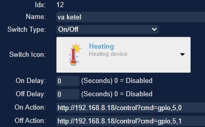

An ESP with 6 relays for 6 valves in the different rooms.
In Domoticz I make 6 virtual switches activated en give
them all 2 url's, open en close.

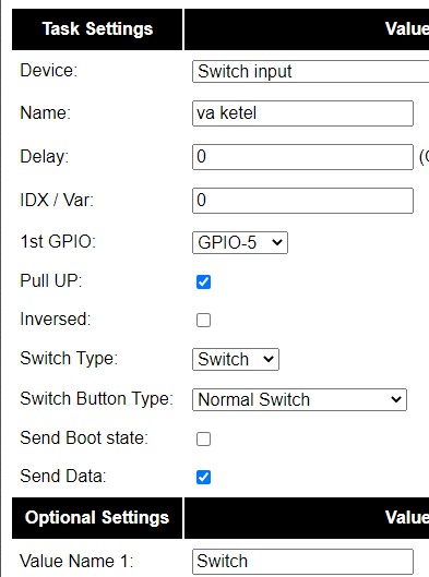

Every time when a switch is activate I get the error
because the IDX of the ESP is zero (0).

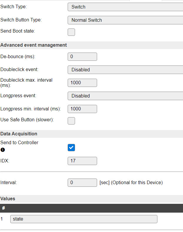

But when i fill in de IDX in the switch the realys bounced.

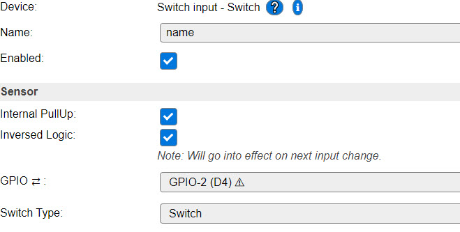

this works for me with espeasy mega-20190404
in espeasy rules
On TurnOn do		// from Domoticz
  gpio,2,0
EndOn
On TurnOff do		// From Domoticz
  gpio,2,1
EndOn
esp device
in domoticz
Regards,
Rob

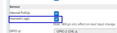

Hello erem,
I think that this issue is under control...
I checked Inversed Logic and now there
are no more error or bouncing relay(s).
For now verry thanks.

Hello again,
It works perfect, the rules were not necessary.
Thanks! Con.
