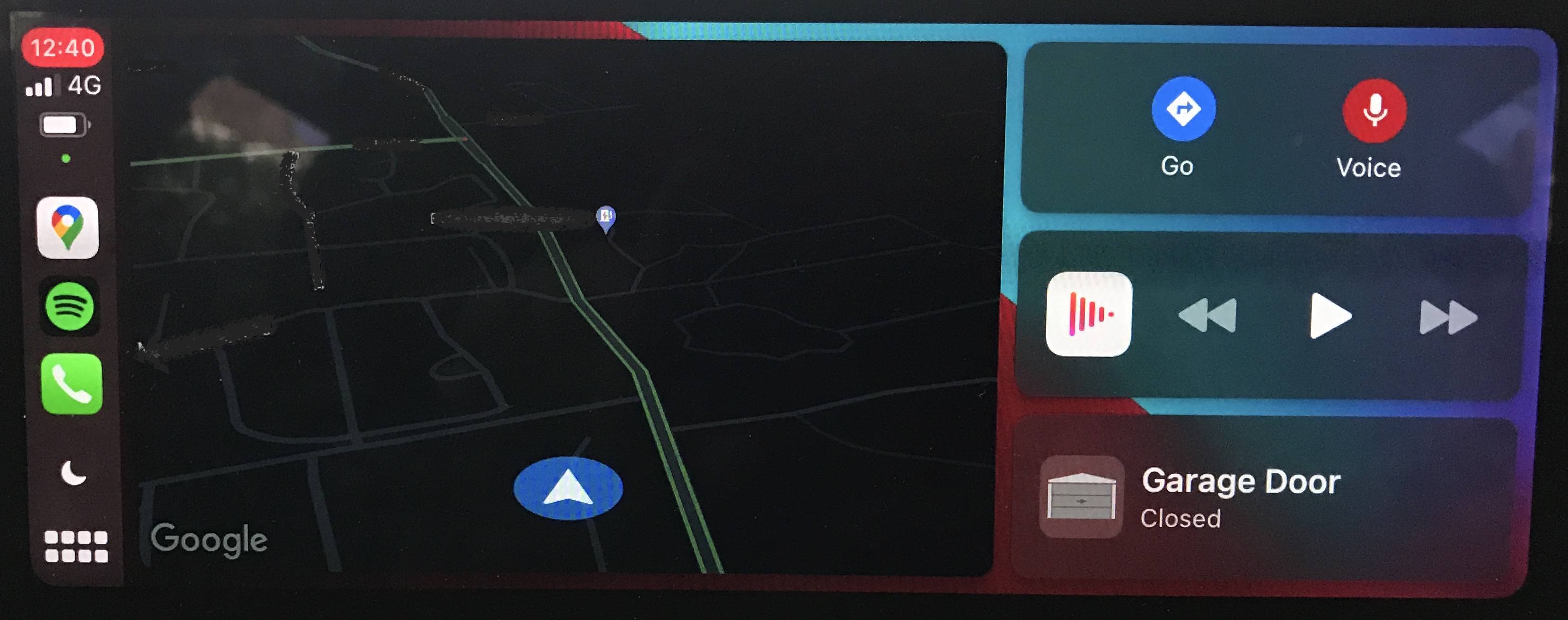

harrykausl wrote: Sunday 27 December 2020 12:22 It's true, there are noc homekit devices in carplay, but I read, that there would be a message in the dashboard of carplay.
There is a Garage Door icon that appears on the Carplay screen (certainly does on my screen). I now have an ESP8266 flashed with https://github.com/RavenSystem/esp-homekit-devices and use this. Only down side is I don't have it linked to Domoticz, so no logs. I tried adding some HTTP GETs to the code, but this messed up the automations I had addedd (turn garage light on at night/off when door was closed) from what appears to be a conflict with the hub sending the command while device is trying to send the HTTP to Domoticz. Further investigation underway.

rjblake wrote: There is a Garage Door icon that appears on the Carplay screen (certainly does on my screen)...
Would love to see a screenshot of your car display? And also a screenshot of how it appears in Homekit?

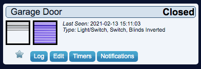

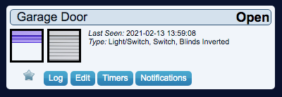

Here is a picture of how it is displayed. Not that Homekit is not really integrated, but this feature relies on Siri Suggestions being turned on in CarPlay.
I have recently changed my Garage Controller as mentioned, so Domoticz integration is not there yet (have created dummy switches that get updated through a HomeKit automation to keep them in sync). Previously was using the solution here, but had to change due to wifi connection problems (only occurred when WiFi lost, then needed reboot). In Domoticz, have it set as a switch, then edit to 'Blinds Inverted'
Open:
Screenshot 2021-02-13 at 15.07.29.png (30.58 KiB) Viewed 885 times
Closed:
Screenshot 2021-02-13 at 15.12.29.png (29.95 KiB) Viewed 885 times
