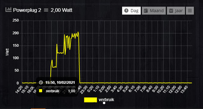

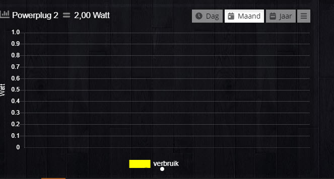

hello a question.
for some kind of reason my filters dont work months and years. it does show hours. ive added the screenshots from dashticz and 1 from demoticz
this is my code:
blocks['StroomVerbruikPlug2'] = {
    title: 'Powerplug 2',
    devices: [232],
    custom : {
        "Dag": {
            range: 'day',
        	graph: ['line'],
            data: {
                verbruik: 'd.u_232',
        "Maand": {
            range: 'month',
        	graph: ['bar'],
            data: {
        "Jaar": {
            range: 'year',
       		graph: ['bar'],
            data: {
    legend: true,
    datasetColors:['yellow']

Re: Graphs doesnt show month and year
Post by Lokonli »
The 'u' value probably doesn't exist for month and year ranges.
I guess you have to use d.v_232 instead of d.u_232.
when you select the month/year view, and then click on the debug button, you can find which values are reported by Domoticz.

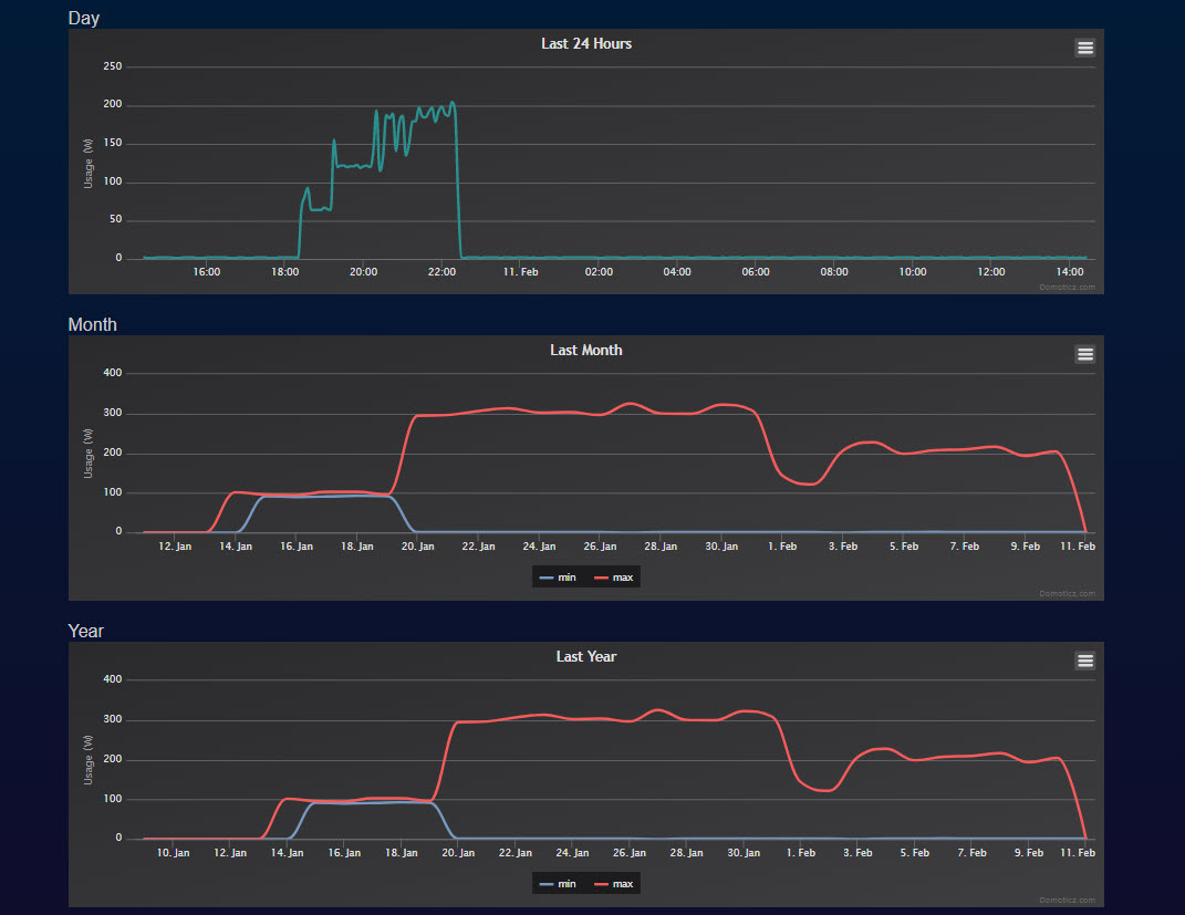

this is what it shows in the debug.

    "status": "OK",
    "title": "Graph day",
    "verbruik": "d.v_232"

FinalX wrote: Thursday 11 February 2021 15:03 looks like its working after changing:
blocks['StroomVerbruikPlug1'] = {
    title: 'Powerplug 1',
    devices: [228],
    custom : {
        "Dag": {
            range: 'day',
        	graph: ['line'],
            data: {
                verbruik: 'd.u_228',
        "Maand": {
            range: 'month',
        	graph: ['bar'],
            data: {
                verbruik: 'd.u_max_228',
        "Jaar": {
            range: 'year',
       		graph: ['bar'],
            data: {
    legend: true,
Yes, indeed. In the debug window you see that Domoticz reports the u_max and u_min values for month data.
