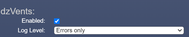

To make searching for the issue a bit simpler please use the standard mechanism for setting the log level and marker and set the dzVents loglevel a bit less strict.
I've changed the logging from "Errors Only" to "Errors + minimal excecution info", then to "Errors + minimal excecution info + genric info" with no change to the log of the script
With "Debug (everything)" I could get a lot more

To set LOG_DEBUG in the script shouldn't be the same?
No the LOG_DEBUG only set some debug logging in the script. If you set it dzVents wide is does dump debug information for all scripts and will display a lot more.
the logging section is to be used for setting the level and marker at a script level. Like

And there, there are are more lines!
In fact I made a mistake! I've forgotten the word level in the logging section!!!
I've put it again and I got the right logging.
It would be convinient to have a syntax control... if "domoticz.LOG_" w/o the key word "level" ; at the present time no error.
