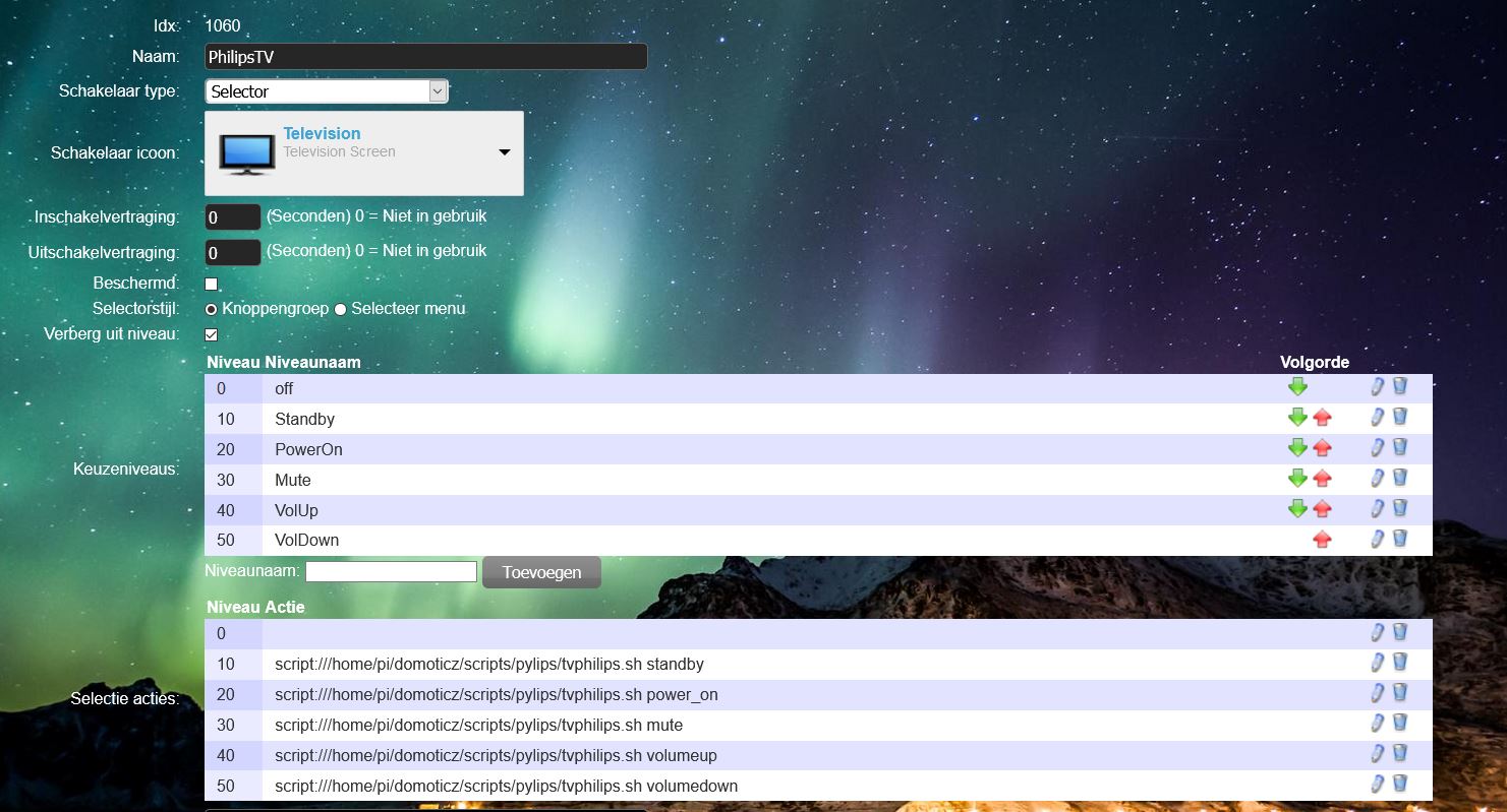

-sudo chmod +x /home/pi/domoticz/scripts/pylips/tvphilips.sh //make executable
-now make a dummy switch in domoticz on/off or selector
and put this commands in on/off
script:///home/pi/domoticz/scripts/pylips/tvphilips.sh standby
script:///home/pi/domoticz/scripts/pylips/tvphilips.sh power_on
script:///home/pi/domoticz/scripts/pylips/tvphilips.sh mute
script:///home/pi/domoticz/scripts/pylips/tvphilips.sh volumeup
script:///home/pi/domoticz/scripts/pylips/tvphilips.sh volumedown

- philipstv.JPG (161.47 KiB) Viewed 3274 times
