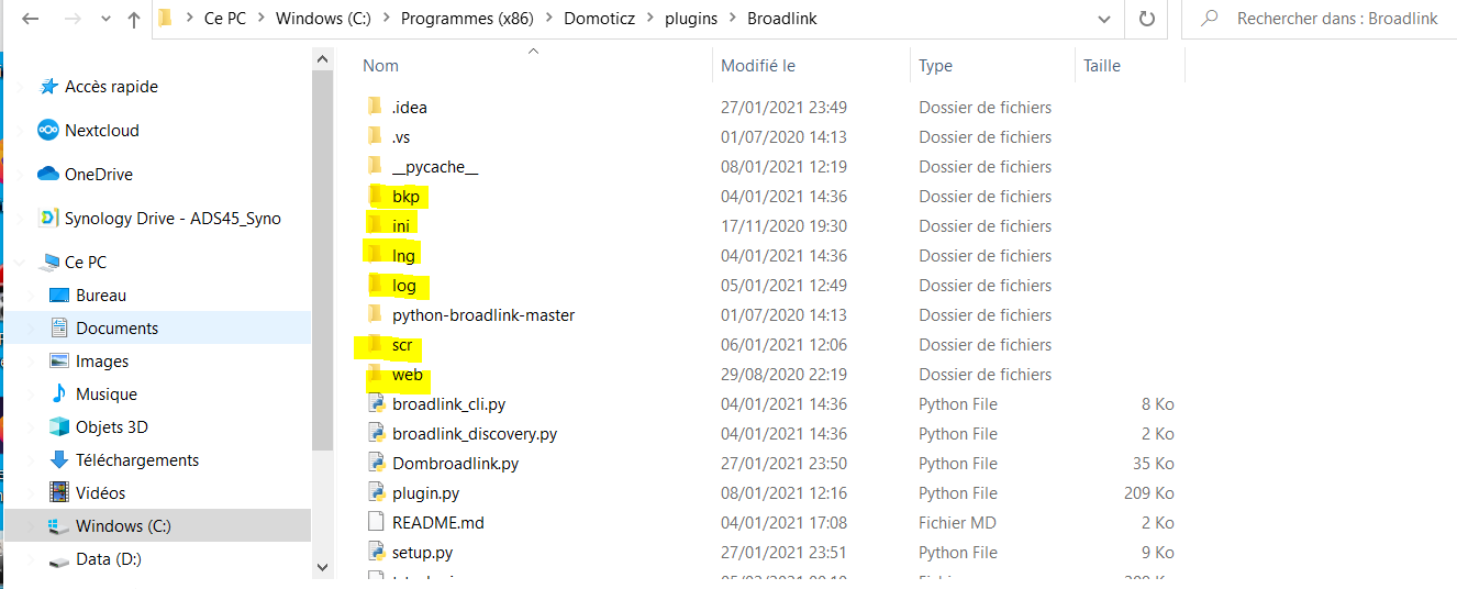

extremeaudio wrote: Wednesday 03 February 2021 13:11 Thanks for the help. I now have the device showing up in domoticz.
But I now get the following errors in domoticz log
2021-02-03 17:35:48.476 FileNotFoundError: [Errno 2] No such file or directory: '/home/pi/domoticz/plugins/Broadlink/log/2RM24M.txt'
2021-02-03 17:35:48.476 Error: (broadlink) Error to retrieve type from this file : /home/pi/domoticz/plugins/Broadlink/log/2RM24M.txt
Verify that this folder exist : '/home/pi/domoticz/plugins/Broadlink/log
and that your process had enough right on it (RW)
extremeaudio
Posts: 47
Joined: Tuesday 24 November 2020 17:57
Re: Python Plugin : Broadlink
Post by extremeaudio »
zak45 wrote: Thursday 04 February 2021 12:20 Verify that this folder exist : '/home/pi/domoticz/plugins/Broadlink/log
No there is no such folder at that path.
extremeaudio
Posts: 47
Should I manually create it ?
zak45
Posts: 954
Domoticz version: V2024.4
Post by zak45 »
these are necessaries folders:
if not present; just create.
extremeaudio
Posts: 47
That worked. Very greatly appreciate your efforts, I was very close to giving up on Domoticz altogether merely because I was not able to control IR devices. Thank you.
