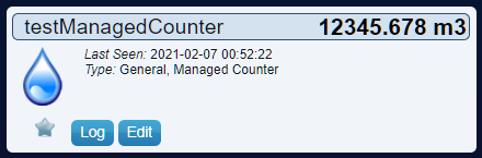

and this in the GUI (utility tab)

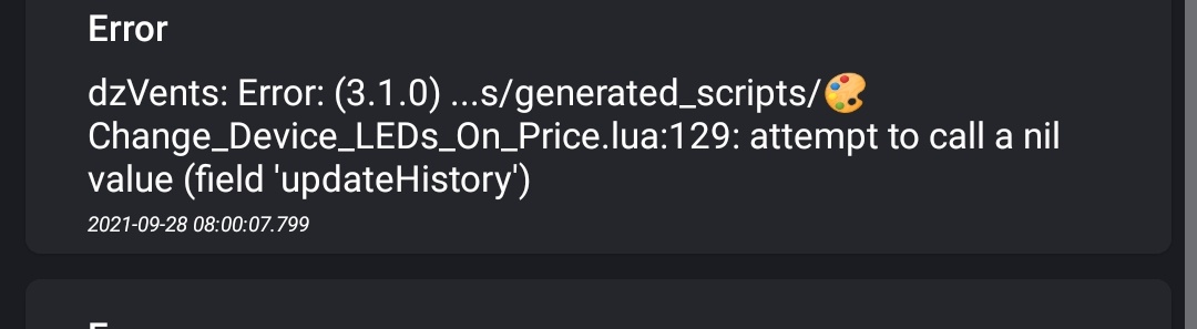

Did this updateHistory for counters get removed since your post here? It's giving me nil-errors when trying to use it
