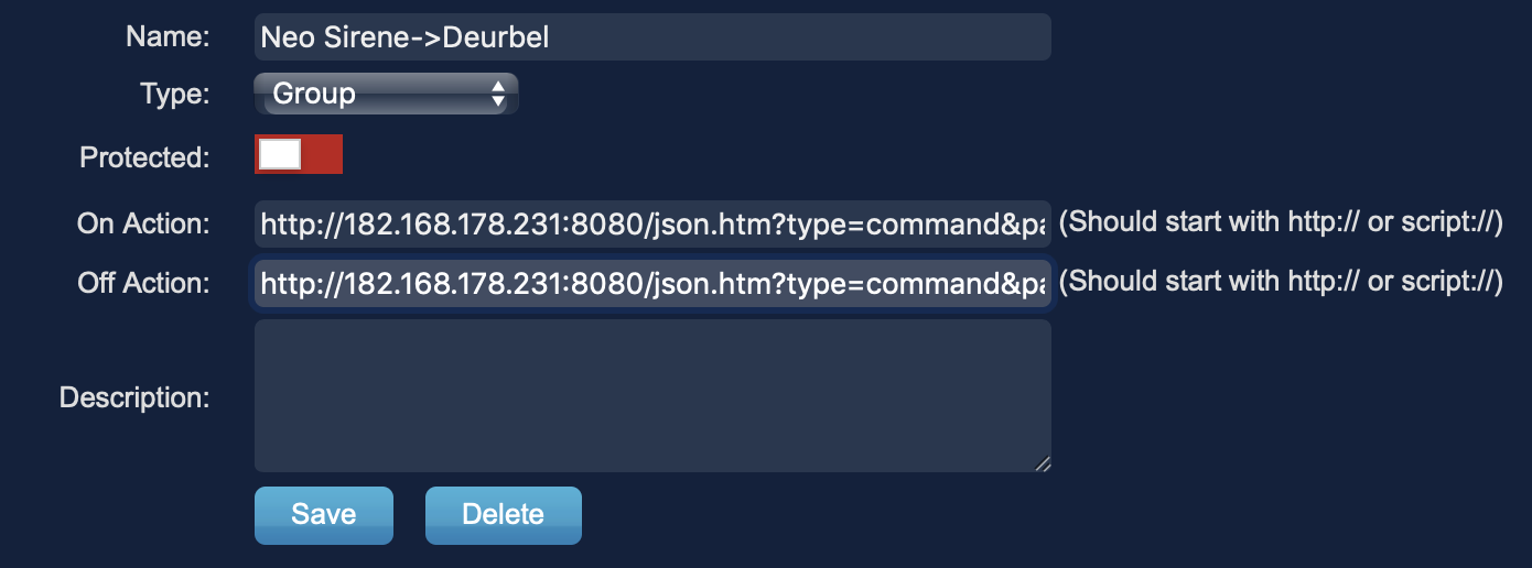

Configure as Alarm
Configure as Doorbell:
So what I have done, is to configure a group and then have these as "on" command and "off" command respectively. Furthermore, I have added the Neo Sirene switch as one of the devices in the group, with an "on delay" of 1 second.
So normally the siren is configured as doorbell, but when the Alarm Group is activated, the device is configured as alarm and then activated after 1 second. If the Alarm Group is switched off, it is reset to the default doorbell-configuration.
The encoding showed to be a little bit different for "1" and "2" then you described as I learned from the debug-info, but this is how it is working for me:
Configure as Alarm
http://domo_url:8080/json.htm?type=command¶m=applyzwavenodeconfig&idx=23&valuelist=7_QWxhcm0gbXVzaWM%3DCode: Select all
http://domo_url:8080/json.htm?type=command¶m=applyzwavenodeconfig&idx=23&valuelist=7_RG9vciBiZWxsIG11c2ljSo normally the siren is configured as doorbell, but when the Alarm Group is activated, the device is configured as alarm and then activated after 1 second. If the Alarm Group is switched off, it is reset to the default doorbell-configuration.

Re: How to reconfigure a Zwave device (Neo Coolcam Siren) with a script?
Why is this URL (to set the Siren function on of the Neo Coolcam) perfectly working in a browser
http://182.168.178.231:8080/json.htm?ty ... bXVzaWM%3D
:feedback: "status" : "OK",
"title" : "ApplyZWaveNodeConfig"
But within a Scene the exact same URL gives errors and won't work:
2018-10-16 20:13:17.617 Error: Error opening url: http://182.168.178.231:8080/json.htm?ty ... bXVzaWM%3D
What's going wrong here?
Thanks for the help!
Solved!
After the change with the local network number in the settings/system/"Local Networks (no username/password) field", the Siren_Doorbell group works perfectly

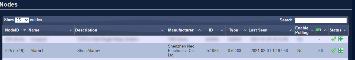

Can somebody assist me with this one?
I bought one of these sirens a while back and I also want to double it as a doorbell. Unfortunately, I cannot get it to work like the previous posts above me. I keep getting the "ERR" message in my browser and cannot figure out what I'm doing wrong. I suspect I'm using the wrong idx, but I'm not sure which one I need. These are my devices in Domoticz: Which id do I need to use?
EDIT: I figured it out. Apparently, Domoticz gives the device another IDX that is not visible anywhere (in my case it was idx 38).
Got it working and I'm able to switch it with the group configuration.
