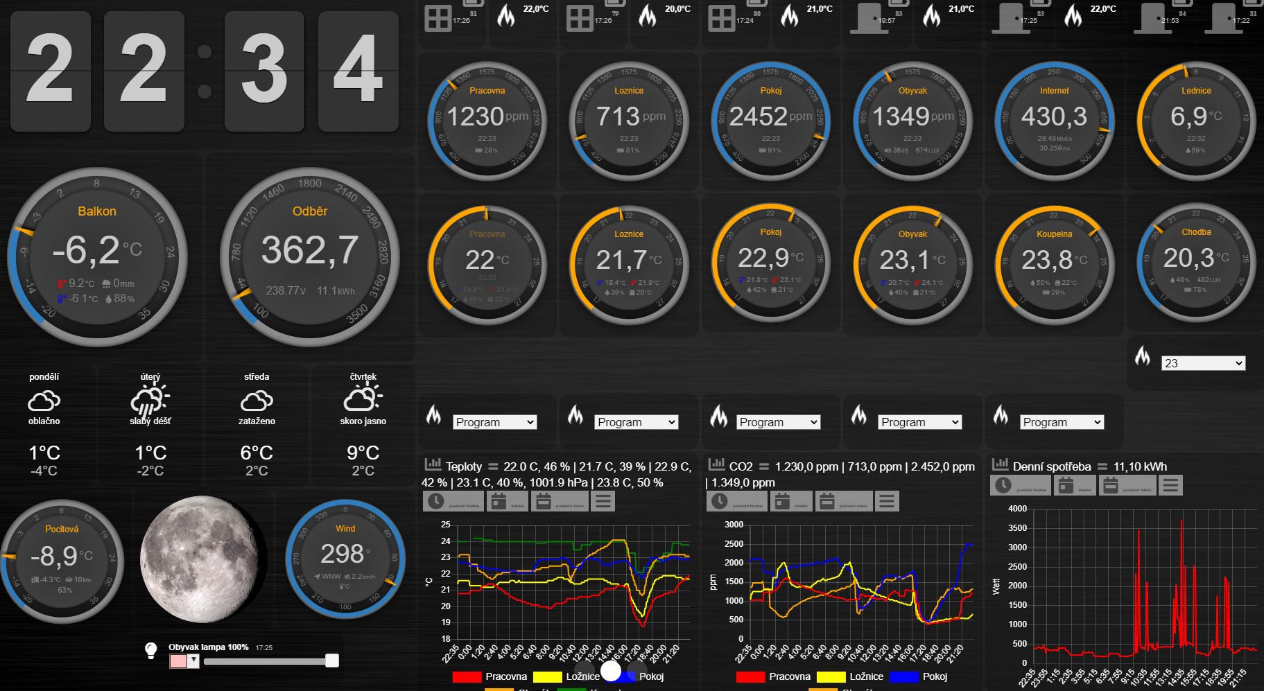

Krenstik
- Posts: 45
- Joined: Saturday 13 June 2020 12:51
Re: Dashticz v3.7.3 beta
HI,
the updated dial is really nice, but some of the dials change size, but I don´t know why, especially if on page one is weather and not he page two is weather o.k. but temp. dials are bigger....
- Snímek obrazovky 2021-01-31 223240.jpg (290.69 KiB) Viewed 1773 times

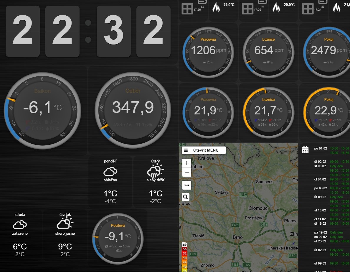

Lokonli
- Posts: 2292
Can it be that a vertical scroll bar appears?Krenstik wrote: Sunday 31 January 2021 22:36 HI,
Dials automatically resize to the block width. If during screen build up a vertical scroll bar appears, then the blocks are a little bit smaller, resulting in a reduced height of the dial as well. Normally dials are only resized after a new device update (with new data) is received from Domoticz.
So that could explain that blocks could become a little bit smaller after a while.
In latest beta I've removed the auto resize functionality of the dials.
Can you test whether this solves your issue?
(I noticed that there might be small difference in dial height in case the dials are not part of the same column)
