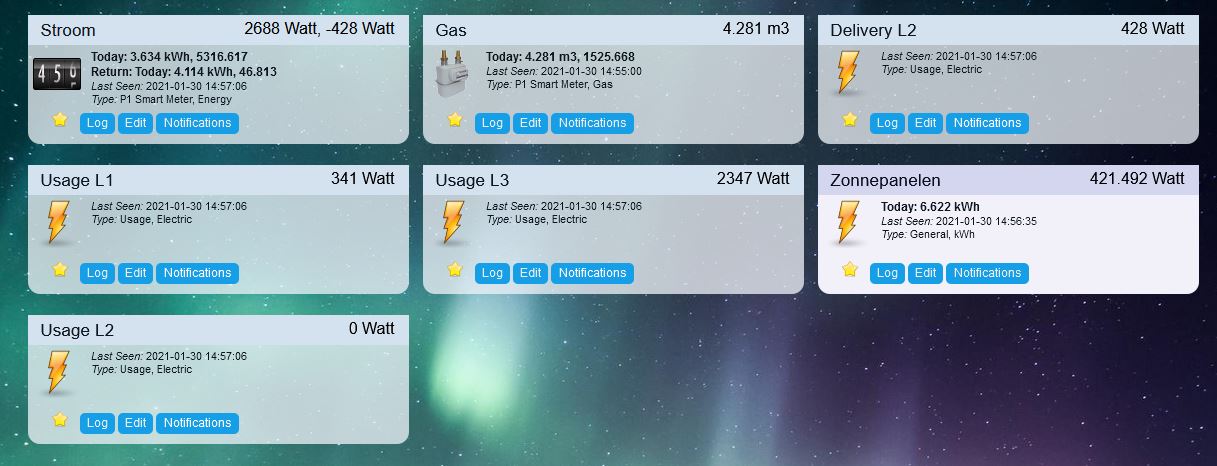

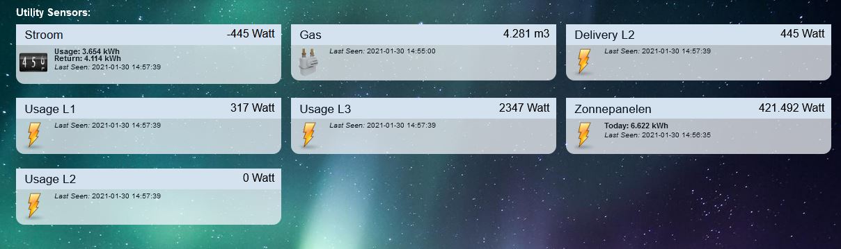

1st cosmetic wish:
I have both activity on my power usage as my power return. but on the dashboard the only value shown is my return value (if active) otherwise it shows usage. On the utility page i see both values and i would like to show the same information on my dashboard for my Power(Stroom) device.
I found This topic wich states my issue and some code to edit to fix this, but the lines given are not consistent with my files and i cant get it to work.. (added some files of my screen)

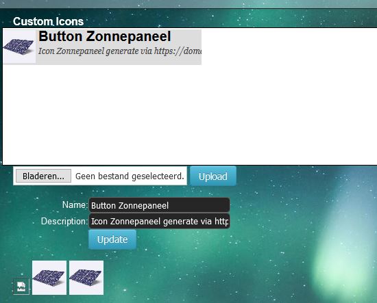

2nd cosmetic wish:
I would love to create a dashboard having only three devices, my power (as shown on the utility page (wish 1) showing usage and active return), Gas (in its current state), and i would love to have a 3th one (dummy), showing a solar panel as icon with the main value showing daily solarreturn Kwh.
Not sure if this is possible i could find a way to change the logo (i did uploaded my custom icon)
solarpanel icon
solarpanel icon
Hoping someone can help me a step forward...
