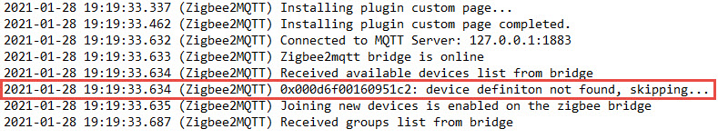

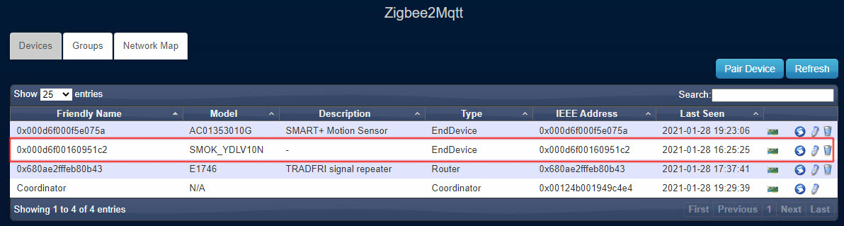

Can anyone help me in adding a HEIMAN HS1SA-E smoke sensor to Domoticz. I am using a Zigbee CC2531 USB Dongle with the Zigbee2Mqtt plugin. In the Custom menu Zigbee2mqtt is seen as 0x000d6f00160951c2, Model SMOK_YDLV10N, but in the log it is written: "2021-01-28 19: 19: 33.634 (Zigbee2MQTT) 0x000d6f00160951c2: device definiton not found, skipping ..."
What could be wrong.

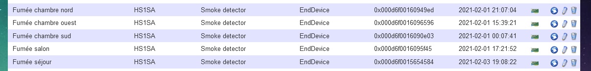

Works for me here with Z2M 1.16.2:
Adapter is a CC2652rb with ZigBee 3.0 coordinator.

Just use the build-in MQTT-Auto Discovery hardware and use zigbee2mqtt.
