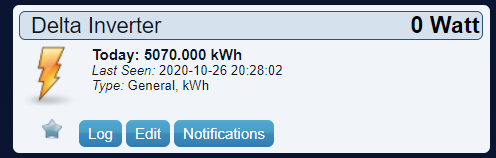

Script was updated to solve this error.

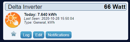

Got some nice readings today but then the counter stopped at 13:05 for no immediate reason. No idea what the issue is.
Manually ran the script and get only the following feedback in domoticz log.
After this, no more outputs. And the dummy still is not updated.
2020-10-28 15:07:49.701 Status: --->> Cookie File: /var/tmp/Delta.cookie exists!
2020-10-28 15:07:49.714 Status: --->> Cookie File: /var/tmp/Delta.cookie NOT writable!
2020-10-28 15:07:49.734 Status: --->> Login OK to proceed ->

It's running changed the script slightly.

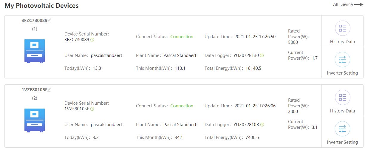

I have 2 converters on the Growatt dashboard ... is it possible to read the 2 individual values instaed of the overall total ?
- Knipsel.JPG (71.79 KiB) Viewed 2953 times
RasPi2 - Aeotec Z-Stick S2 - Fibaro multisensors - Fibaro RGBW dimmers - ETH08 relais boards
- sincze
- Posts: 1302
- Domoticz version: 2024.4
Re: solar panel readout for delta inverters (my delta solar cloud)
Growatt or Delta ?
Ofcourse if data is available the script can be tweaked to fill multiple devices in Domoticz. 1 per inverter for example.
