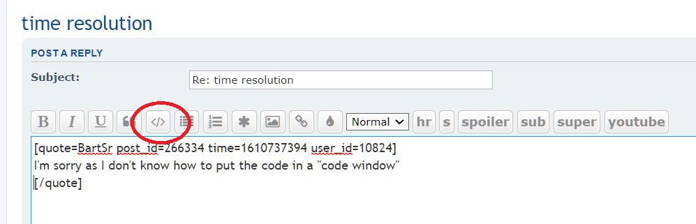

click on the marked button and paste your code between the inserted tags.BartSr wrote: Friday 15 January 2021 20:03 I'm sorry as I don't know how to put the code in a "code window"
