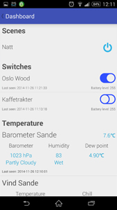

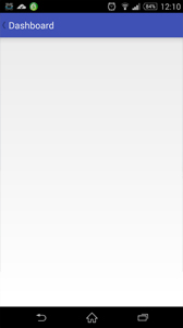

Hi, first: Thank you for a great app!
But I have an issue with the Dromotica app.
When I'm in the app, and my phone's screen times out, the apps "pages" like Dashbord, Switches, etc. it blank when I activate the phone again. Same issue if I press "home" button on my phone, and then open the app again.

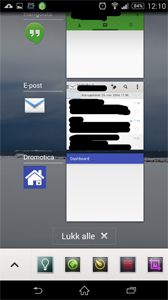

I need to manually close the app using "recent apps", and then start the app again to get back my devices in the different "pages".
Is this a known issue, or is it just me?
This is how it should look

This is how it looks after screen timeout, or switching to an other app.
I need to swipe to close the app, and then start it again.

I noticed this problem to. When you close the app with the home button and reopen the app at a later time you get a white screen.
When you select the back button you get back to your previous selection (switches, utility, etc). So I preffer the use of the home button.

The bug with the empty screens I'll fix in a next update. That will take a bit before it's available as I'm working on a new feature that will also be included.
