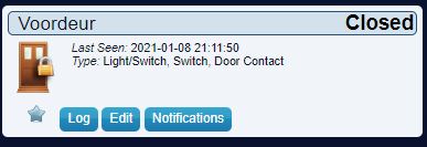

Hi, I am using a silvercrest doorsensor with Zigate running on Synology NAS.
It worked fine for some time, but now -since several days- is not receiving switch signals anymore (see log), although Domoticz indicates that it still sees the device via indication “last seen”.
Any clues what to do? .
Silvercrest door sensor not logging

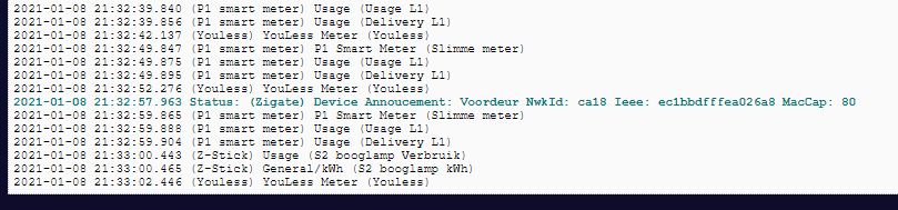

Additional info: the domoticz log is showing:

If I understood the sensor is still on the network sending for instance Device Annoucement,
the lastseen is updated regularly which confirm it is on the network and communicating .
Did you check the battery ? are they still good ? I have seen some device with Low Battery able to send Device Annoucement (whcih basically is a connection to the network) but not able to send anything else.
If it works a while and suddenly stop with this behaviour I would consider something like that.

Hi Pipiche, batterylevel is still good (only few weeks old), Zigate UI is showing a healthy node. Very strange. I removed the device in Domoticz and reinstalled it as a new device in Zigate again (all history logging is lost af course). Now it is working again, but what actually happened remains a mystery. If I trigger the device I instantly get the above status in the log...(Device announcement: etc.)
Hopefully it will stay on track now.

@waltervl as part of the Zigbee 3.0 standard an end device (battery based) must do a Device Announcement when the device wake up (even if alreday on the network). What is behind is that as the end device can sleep for a long time and wake up after it might not be ready on the network side to handle the communication. This is why.
@Knarf99 the reason is healthy in the Web UI is simply because the plugin has received a message from the device, and Device Announcement is one.
