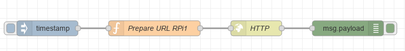

The following flow will get the User variable to Node Red.

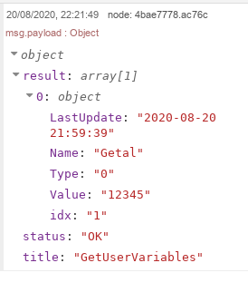

And it will give the following output:
As you can see an array of objects has been returned, each containing info about the user variable.
You can also ask for a specific IDX by changing the call and add the IDX, but in this case the returned msg is identical.
Please find the flow below (for a single IDX).
[{"id":"c194714d.dd08b","type":"inject","z":"4268f77.7847488","name":"","props":[{"p":"payload"},{"p":"topic","vt":"str"}],"repeat":"","crontab":"","once":false,"onceDelay":0.1,"topic":"","payload":"","payloadType":"date","x":160,"y":220,"wires":[["a77e308e.7145b8"]]},{"id":"a77e308e.7145b8","type":"function","z":"4268f77.7847488","name":"Prepare URL RPi1","func":"var url = \"http://127.0.0.1:8080\";\nmsg.url = url + \"/json.htm?type=command&param=getuservariable&idx=1\";\nreturn msg;","outputs":1,"noerr":0,"initialize":"","finalize":"","x":370,"y":220,"wires":[["4f6ff499.397524"]]},{"id":"4f6ff499.397524","type":"http request","z":"4268f77.7847488","name":"HTTP","method":"PUT","ret":"obj","paytoqs":"ignore","url":"","tls":"","persist":false,"proxy":"","authType":"","x":570,"y":220,"wires":[["4bae7778.ac76c"]]},{"id":"4bae7778.ac76c","type":"debug","z":"4268f77.7847488","name":"","active":true,"tosidebar":true,"console":false,"tostatus":false,"complete":"payload","targetType":"msg","statusVal":"","statusType":"auto","x":750,"y":220,"wires":[]}]
I think, this is where you are looking for.

As you look to the picture of August 20 you see that the output is an array of objects.
In this example the array contains only 1 object, as I have only 1 User Variable.
In the picture you see, that the data, you are interested in, is indicated by Value and the value is "12345", which is an integer value, presented as a string (because it is between " ").
Now, if you hoover with your mouse over the line Value: "12345", you will see that a couple of extra buttons are shown. The most left of these will copy the complete path to the clipboard. In this case payload.result.0.Value. Now you can easily paste the contents of the clipboard to another node, such as a Function node.
When I dump the content using a debug node I can see the correct value as string.
If you push this to a debug node as msg.payload.result.0.Value you will only see "12345" or something.
To understand, I recommend to read: https://nodered.org/docs/user-guide/messages and then specific: Understanding the structure of a message.
My next step was to feed that into an input node, but for some reason this value never shows up! Any hints?
As you have seen, msg.payload.result.0.Value represent a specific value.

OK, I solved one part of the puzzle.
The zero in that info is actually the index of the secondary object.
So accessing the value is:
msg.payload = msg.payload.result[0].Value;
This isolates the value and puts it to the output of the node.
Now to set up the input field...
