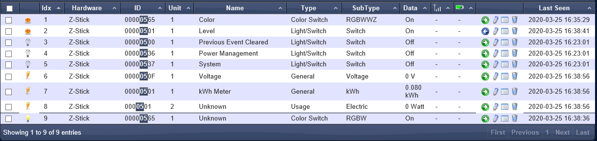

When adding the Fibaro RGBW Controller 2 to Domoticz, I'm missing some devices.
The device needed to switch on/off/dim the light is missing. I tried all devices that were found, but these are not working.
Just the following devices are discovered:
RGBW Controller 2.PNG (69.38 KiB) Viewed 2402 times

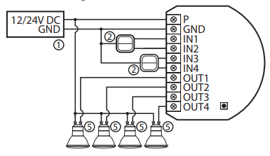

I want to switch 12v halogen lights connected to the "R"/"Out 1" channel as shown in the manual:

So all wires are connected correctly, I just miss the device in Domoticz to apply the action to.

After discussing this with the author of the adjusted xml files for the FGRGBW-442 he states that the XML-files aren't finished and need further work. That's probably the reason not all devices are being found.
He also states that open-zwave might only support version 2 of the command class color switch and that the module is using version 3. But he's not sure if this is causing the problem.
Concluding, the open-zwave implementation for this device needs further work.
