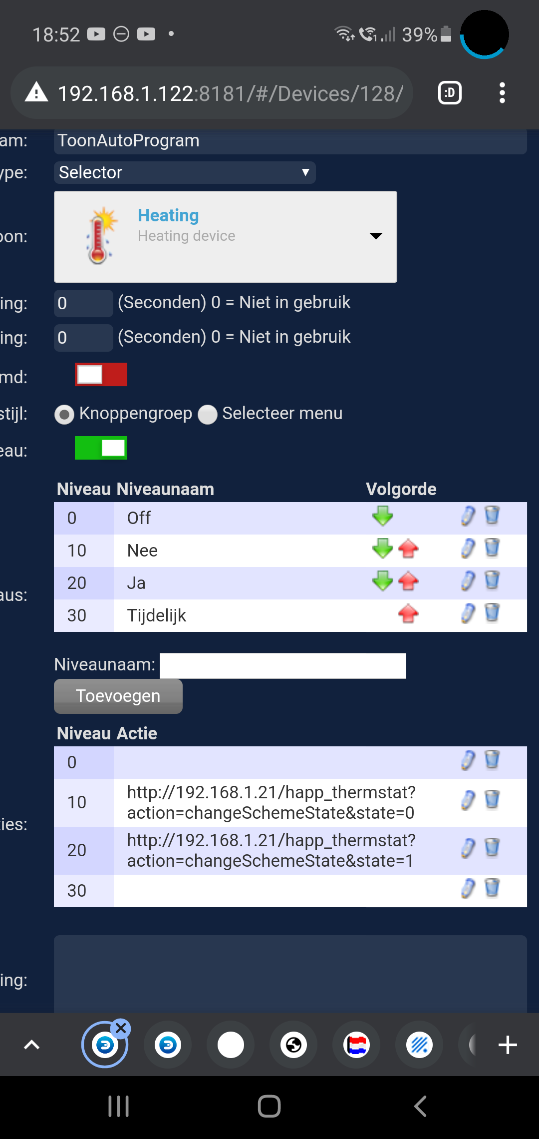

These settings?
- madpatrick
- Posts: 667
- Joined: Monday 26 December 2016 12:17
- Domoticz version: 2025.1
Re: Controlling Toon [HACKED] from Domoticz
Yes. It is for me unclear why it is not working
The trigger “ Tijdelijk” looks valid.
If you breakdown the blocky script with the IF function and at DO only a log function. Do you see the message in your log ?
And then step by step add functions

When you change a temparature to a Progam temperature, the program status is not set to this status
For example if you Home temparature is 20°C and you change the Setpoint to 20°C, the Program remains Manual and not Home
The plugin does not have intelligence, it just reads back what the Toon has to tell (and interprets that).
I did this test at my home just now, where home is 20.5 C and comfort is 21.0 C
1) Toon is in home mode
2) On domoticz I increase the setpoint from 20.5 to 21.0
3) Result: Auto program goes to Temporary and Program goes to manual
4) On domoticz I set the setpoint back to 20.5
5) Result: Auto program goes to Yes and Program goes back to Home
It should indeed come from the Toon.
In the script there is a work around to read the temperature and set the Toon to the correct scene.
Looks like to Program has a link with the temperature setting and also sets the scene correct.
