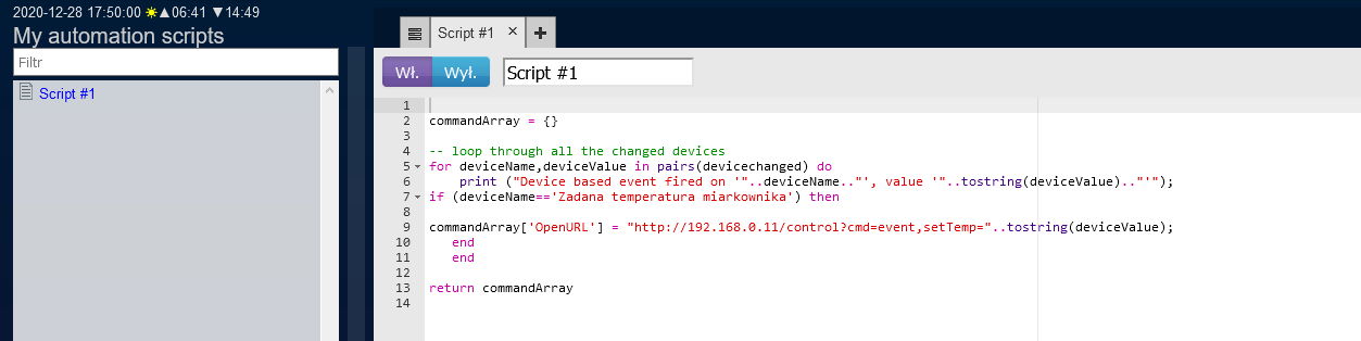

piotrux
Joined: Monday 28 December 2020 18:44
Re: Python Plugin: Smart Virtual Thermostat
Post by piotrux »
Hello, I wanted to use the plugin to control the temperature at home, but I do not have an on / off heater, only a thermostat on which I set the temperature on the stove, is it possible to change the plugin so that it controls the temperature of the stove? I am using a script to control the temperature as below:
Bez tytułu.jpg (48.57 KiB) Viewed 2241 times
jake
Posts: 751
Post by jake »
piotrux wrote:Hello, I wanted to use the plugin to control the temperature at home, but I do not have an on / off heater, only a thermostat on which I set the temperature on the stove, is it possible to change the plugin so that it controls the temperature of the stove? I am using a script to control the temperature as below:
I have an opentherm gateway and manipulate the thermostat setpoint to trigger the boiler. (1 degree above current room temperature)
rrozema
Posts: 470
Location: Delft
Post by rrozema »
piotrux wrote: Monday 28 December 2020 18:54 Hello, I wanted to use the plugin to control the temperature at home, but I do not have an on / off heater, only a thermostat on which I set the temperature on the stove, is it possible to change the plugin so that it controls the temperature of the stove? I am using a script to control the temperature as below:
Using svt to set a temperature on another thermostat defeats the purpose of having a smart thermostat: svt is meant to save on your energy bill by automatically 'learning' the characteristics of the room(s) and your heating equipment. It does so by switching your heating device on and off just long enough to get (and later keep) your room(s) at the desired temperature with as little as possible overshoot and least possible used energy. If you try to make svt set a setpoint on some other thermostat it won't be able to learn nor control anything.
So, SVT replaces your existing thermostat. You'll have to remove your existing thermostat and put some sort of switch device in it's place that can be controlled from domoticz. Then you can use svt to manipulate that switch and thereby the stove.
piotrux
Post by piotrux »
Thank you explanation. My stove is old there is no on and off switch. I have custom thermostat build on "let's control it". In that case how can i adjust to make it work? I want a constant temperature in the room thanks to netatmoand SVT.
