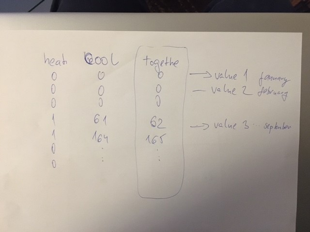

Re: LUA scene string
ok:
API my daikin: http://192.168.1.180/aircon/get_year_power_ex
string from API DAIKIN: ( number are consumption by months this year, prev year)
ret=OK,curr_year_heat=0/0/0/0/0/0/0/1/1/0/0/0,prev_year_heat=0/29/31/35/30/12/0/0/0/0/0/0,curr_year_cool=0/0/0/0/0/0/61/164/46/37/36/25,prev_year_cool=0/0/0/0/0/91/33/70/34/5/0/0
You givi me your script and I put in virtual device. But it is only for curr_year_cool. I would like to have consumption by month cool+heat and total consumption in my fibaro. Picture virtual device and VD in attachment. flb is file from fibaro export.

It is not working. I get tablecool and tableheat but no together table. For example August there is iny table heat 1 , in table coll 164. I need prin table together and I need August 1+164= 165. After that i need send 165 to "ui.label8.value" which representative august. Other september in heat is 1 , september in coll is 46 I need 1+46=47 and after send number 47 to "ui.label9.value" which representative august.
I need split myHeatingTable + myCoolingTable to one togethertable and after take from this togethertable send value of the month to value 1-12.
MP
How can I do it? I need this in want.jpg in attachment.
