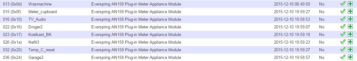

[b]Hardware:[/b]
Sample (sort your hardware in case of multiple of same devices):
[attachment=2]Everspring AN158 population.JPG[/attachment]

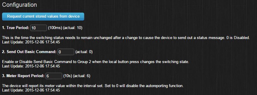

[b]Configuration:[/b]
Show the configuration options here (see sample)
[attachment=1]Everspring AN158 configuration.JPG[/attachment]

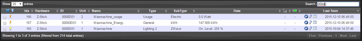

[b]Devices[/b]
Show your resulting devices here (see sample)
[attachment=0]Everspring AN158 devices.JPG[/attachment]

Good initiative. Doesn't seem like a lot of people are using it.
Another thing: in your screen shots I notice device 165 is exactly showing an issue that you see a lot! The node has been seen recently and some of the devices under the node as well, but one device has not been seen for two months! The only way to get this underlying device active again is by removing it and including it again.
