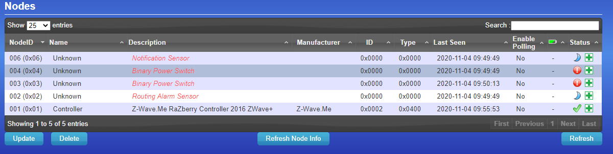

Well this topic certainly does not sound promising. I've got pretty much the same setup but no devices yet. i first wanted to see whether the RAZ V1 could be added or not. That appears to be working although I dont know what the unknown devices are. Did OZW create them or something?...and what the difference between a node and device? Node is physical and device could either be physical or virtual?...

I'm not sure why you've got so many nodes, I've never seen that before. I would simply select each unknown device, and click delete in the bottom left for those.
About node vs device: A node is a physical device (AFAIK, you can't have virtual nodes, it has to be a real device), and a device is a part/section of that physical device. I know, kinda confusing.
Example:
Node: Weather sensor
Devices:
- Rain sensor
- Temperature sensor
- Humidity sensor
Node: Smart plug
Devices:
- Switch
- Power meter
Node: RGB LED strip controller
- R channel dimmer
- G channel dimmer
- B channel dimmer
- All channel dimmer
- Power meter
All these 'devices' are part of the weather sensor node, but provide different functionality. This could also be the same functionality, for example in a power strip that has power metering for each outlet separately, that would give you X power meters, where X is equal to the number of outlets on the power strip.
