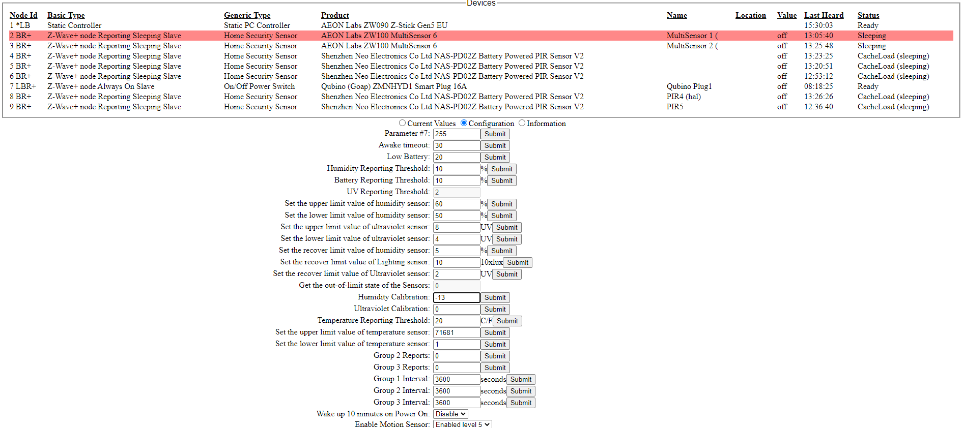

I went to OpenZWave Control Panel (Hardware > Z-stick > Settings > Control Panel)
I want to set correction values on Temp and Hum, since Domotics does not allow this for both individually.
However, the Control Panel disappointed me, since it doesn't seems to send my config update.
In OZW_log.txt is see this:
2020-12-11 09:56:49.912 Error, Node002, ERROR: Dropping command, expected response not received after 1 attempt(s). Command: "SensorMultilevelCmd_Get (Node=2): 0x01, 0x0b, 0x00, 0x13, 0x02, 0x04, 0x31, 0x04, 0x03, 0x01, 0x25, 0x14, 0xe7"
Now what would be the best way to go?
I have tried Battery and USB powered, doesn't seem to make a difference...
Schermafbeelding 2020-12-11 133002.png (142.95 KiB) Viewed 247 times
