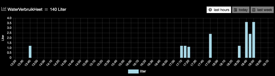

Screen Shot 2020-11-24 at 19.23.56.png (33.23 KiB) Viewed 733 times
I have my watermeter (for hot water) shown in a bar graph. That works fine.
But the graph shows the usage for a period of time, not for the total usage from that starttime.
Example
hot water running for:
5 minutes to get hot water for shaving. say 5 liter
3 minutes to brush my teeth (with cold water, so nu usage)
10 minutes shower. say 25 liter.
This will often give at least 2 bars, sometimes 3 depending on the time on the x-as.
What I hope to get is the total from starttime to finish time with max x minutes between the usages. (5 minutes would do I guess).
The goal is to easy show my children how much water they use during showering to make them more aware of their usage.
Who can help me achieve this?
Thanks, Marcel

When i look into the database of Domoticz and select Meter and my Hot water usage meter (The variable), it looks like the value is just written to the database every 5 minutes.
So my feeling is, that the part in the script that was there to write a record to the database, even if there is nu water usage, is actually not needed anymore. I commented out that section in the script, and still my variable is updated every 5 minutes....
So my best guess is that I have to make something else to collect the length of every usage and show that in Dashticz.......

Ah! Now I think I understand what you want.
My suggestion would then be to write a script in DzVents that counts the pulses from your water meter and if the pulses don't come in anymore for, let's say 1 or 2 minutes, then sent the total to the incremental counter. This way, the consumption of one time using hot water is written as a total with the same timestamp. Small disadvantage is that usage is logged at the time the tap was turned off (or actually 1 or 2 minutes after that depending on the delay you chose).
