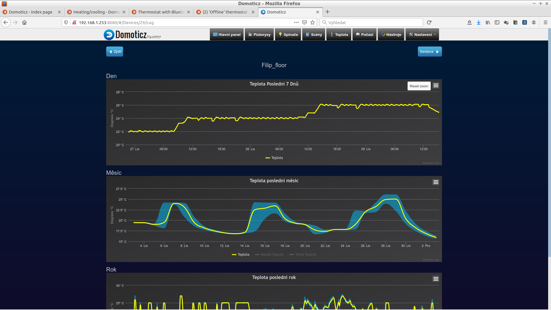

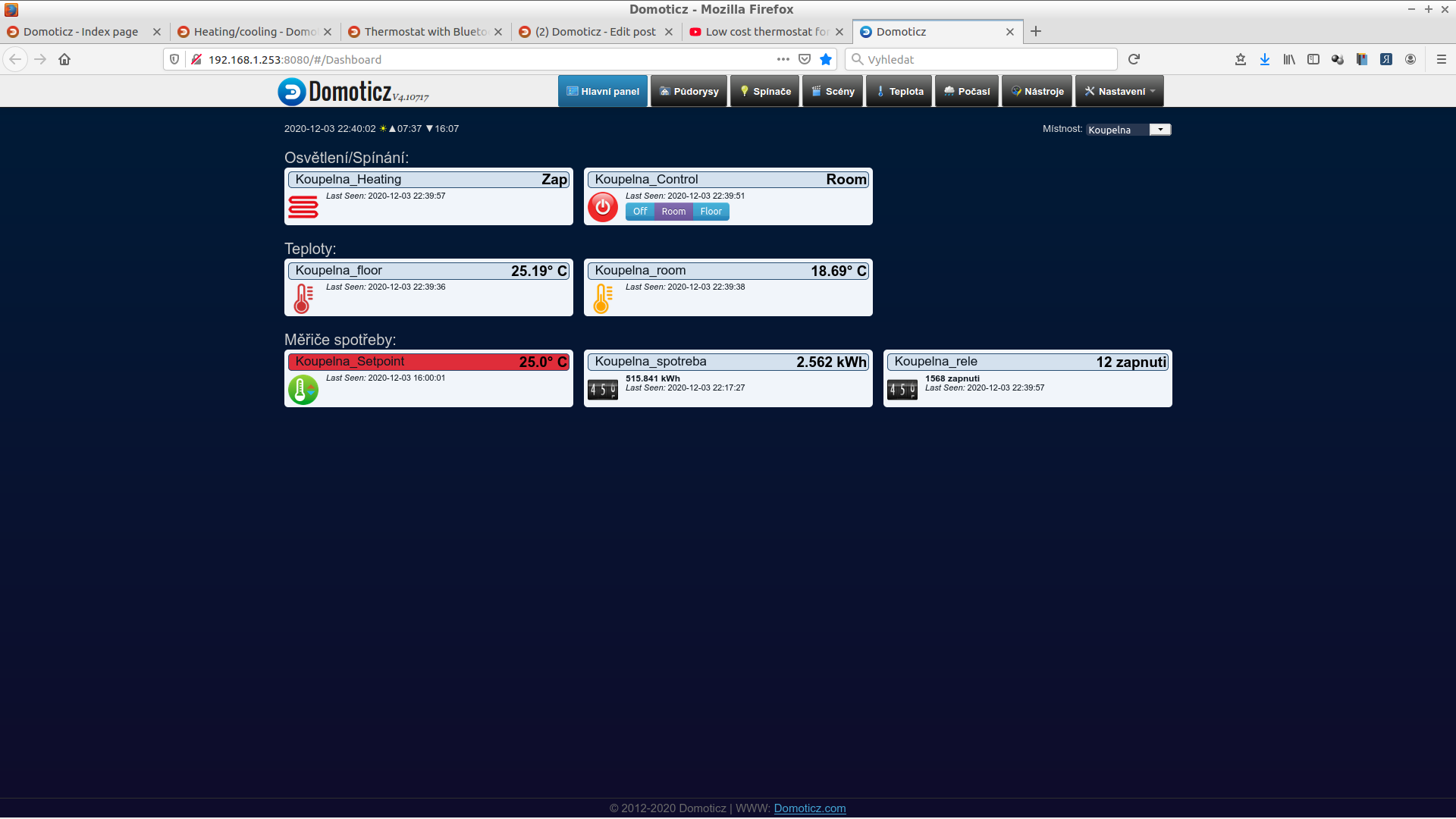

My "offline" thermostat works 3rd winter without any problem.
Not Tasmota but ESPeasy with "rules".
ESPeasy holds temperature ( room or floor ) and sends heating status, temeperatures, energy consumption and number of relay actions to Domoticz.
And make some "safety" - check max allowed floor temperature, setpoint in allowed range etc.
Domoticz sends to ESPeasy setpoint and if floor or room temperature is controlled.
