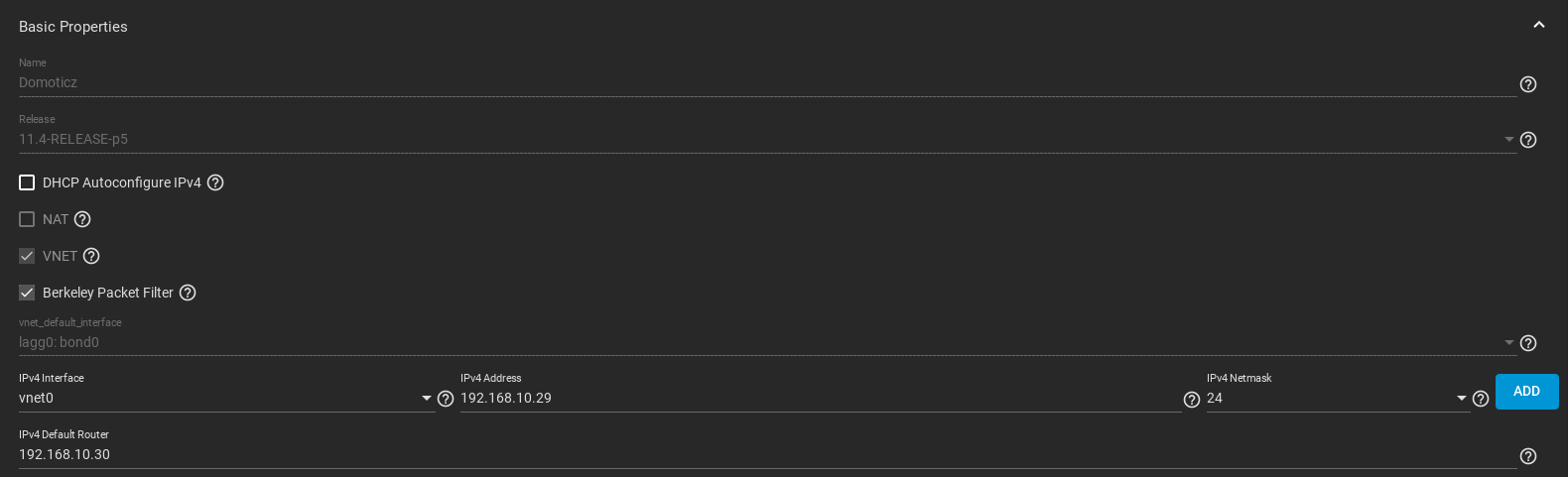

Step 1.
Create the jail in the TrueNAS Gui. I called it Domoticz
Step 2.

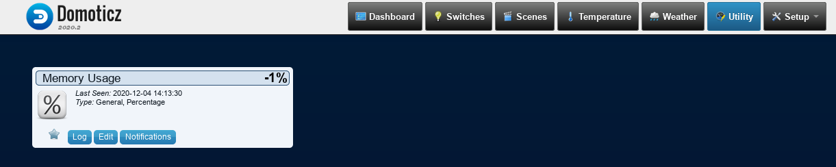

and go to your browser: http://<Your IP address>:8080
The first item, I configured were the "Motherboard Sensors".
Only one is available and that is Memory Usage with a negative value of -1%.
It gives also an error on the https port. But that is not so difficult to solve.
Also it does not give you the version number (except 2020.2), but I assume it is the most recent.

Step 1.
Step 2.

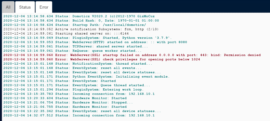

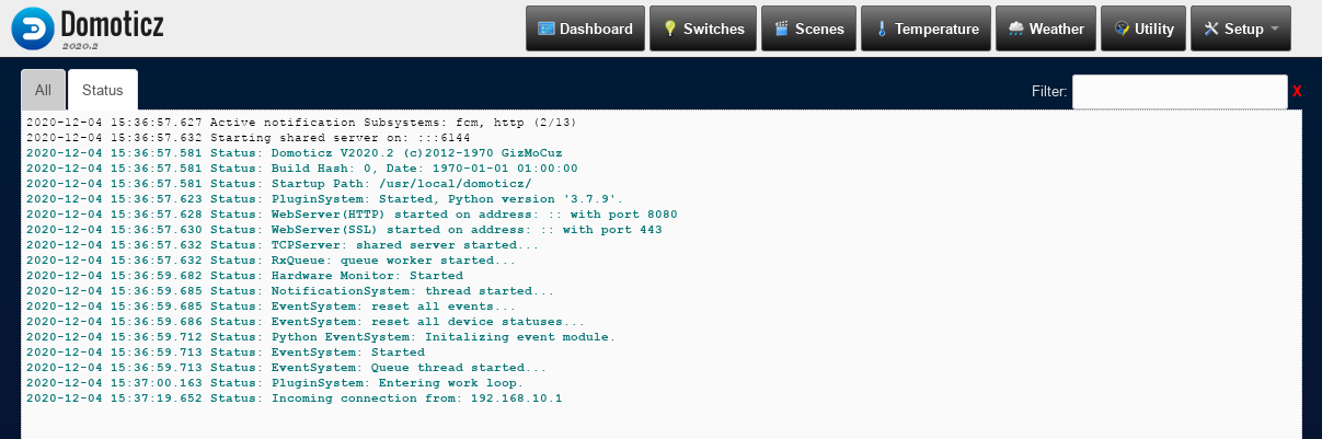

To solve the problem Error: Webserver (SSL) follow the procedure as described in the Wiki.
See: https://www.domoticz.com/wiki/FreeBSD
Add to the file /etc/rc.conf beside the line
also the linesdomoticz_enable="YES"
Command:domoticz_user="root"
domoticz_group="wheel"
cd /etc
