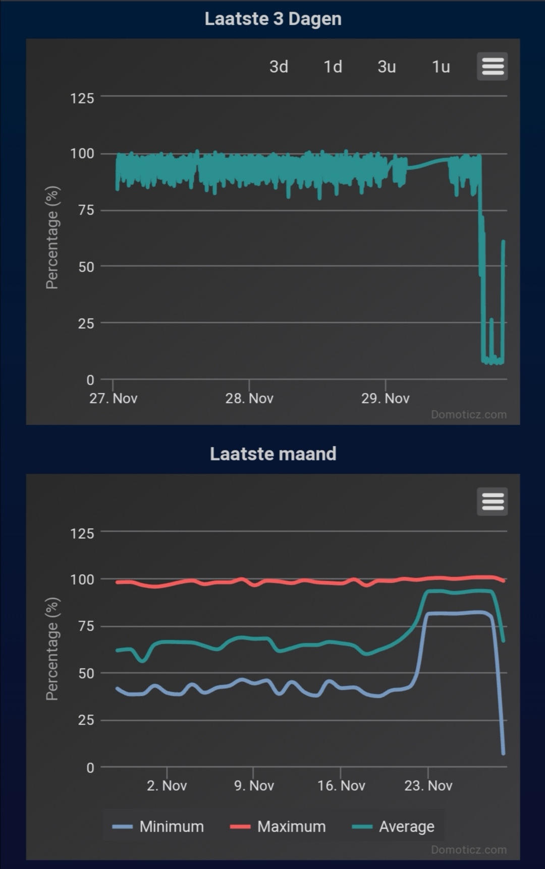

roblom wrote: Sunday 29 November 2020 17:03 Since 21 November the CPU is really high, average is about 92%.
When I use "top" it shows Domoticz is taking up 90%.
I use a Raspberry 3B, storage is 16Gb SanDisk sd-card which is 17% in use. Maximum memory usage is also risen since the 21th.
CPU usage of domoticz is much higher then usual so something seems to be wrong.

Like I said in my previous post, when I remove all DzEvents scripts the CPU lowers to 10-15%.

Of course I can send it, but it also does it with the consumption script I gave above.
DzEvents on.
No scripts in DzEvents script folder.
CPU ~20%
DzEvents on.
Consumption script in DzEvents script folder
CPU ~55%
Also note that I didn't change the DzEvents scripts for months and they all where working fine before the 21th.

CPU logging
CPU logging
