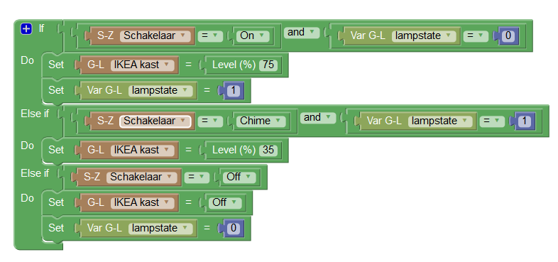

Re: Blockly examples
is there a way to 'event' a press at the wall-mounted switch (Klik aan klik uit WST-8800)?
When switched on or off, the 'state' remains in that state until it is switched. (deep; I know)
but imagine when it is on, and I press the on button again - I would like to use that event to step down the dimmer a few percent. - Possible? not that I expected anything from it; a 'chime' event is not working

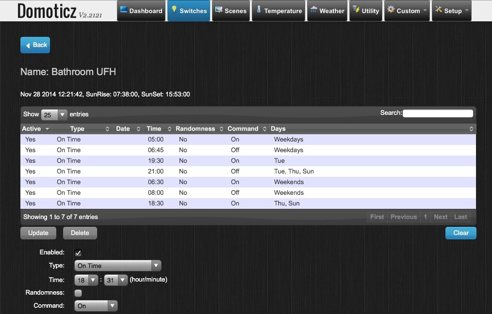

In the mean time - here's some more examples:
This turns on the bathroom heating for 90 minutes on weekdays, except wednesday, at 0500 for 90 minutes. Making sure the bathroom is quite comfortable by the time you get up

I've done similar to this with my bathroom underfloor heating just using the timer on that switch.Wirehead wrote:In the mean time - here's some more examples:
This turns on the bathroom heating for 90 minutes on weekdays, except wednesday, at 0500 for 90 minutes. Making sure the bathroom is quite comfortable by the time you get up(you might want to open the image in a new frame - as it's quite wide)

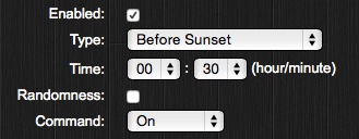

Hi!
I'm trying to make a event for my lights. i Would like it to turn on 30 minutes before sunset and would like it to turn off at a given time on weekdays.
And on holidays i would like to use the same sunset rule but turn of at diferent times.
Is this possible?
Is this possible?
Wirehead
- Posts: 18
- Joined: Saturday 22 November 2014 8:02
afaik - scripting that specific time is probably only possible in LUA...
edit: should be doable using timers - see attached file
- timer.jpg (24.13 KiB) Viewed 45513 times
