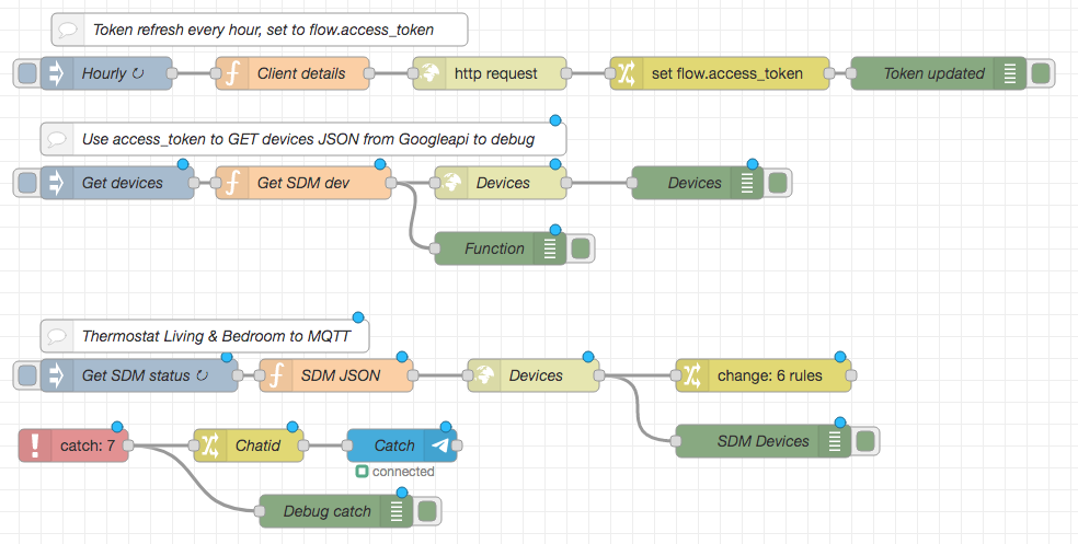

I've not been patient so I've found a solution to my need for the API connection. I have found it in Node RED, did some tinkering in the past days and the API is up and running. relaying info back to Domoticz via MQTT.
The NODE red flows I've created based on a post on the Home Assistant forum:
Screen Shot 2020-11-09 at 08.56.17.png (107.49 KiB) Viewed 1655 times
I already ran thru the Guide on the Google device-access API to obtain the projectid, token and refresh token.
The top flow runs every 3500 seconds, that is the refesh of the token and et as a context data (within the flow in this case).
The the 2nd flow gets the data from the API with the token so you can copy/paste the json objects.
The 3rd flow runs every minute, gets the data from the SDM API injects/transforms that data and forwards the thermostat temp/humidity data to my MQQT broker to update the Domoticz devices.
The Catch flow is to send a telegram message to my phone, I want to be notified in case the API does not work.
