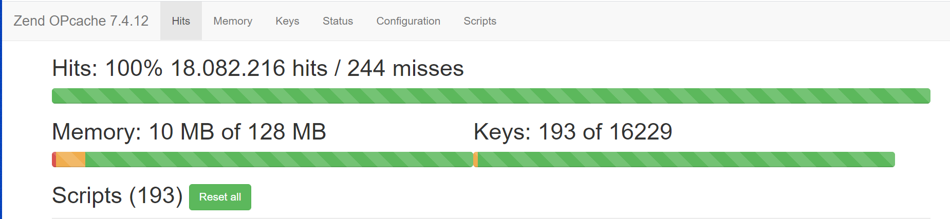

To speed up Pass2PHP (and I know you already did some extensive research in the past).
Was PHP preloading ever considered ??
https://www.php.net/manual/en/opcache.preloading.php
I've also done experiments with NGINX + Cache but enabling that gave me some mixed results.
_cron5.php did not appear anymore in my Domoticz log.. after disabling the cache it started working again.
Ofcourse by default Opcache is enabled.
But I was wondering if we could squeeze some more juice out of the system.
tnx
Sándor
Pass2php
USB: RFXCom, ZWave, Sonoff 3
MQTT: ZIgbee2MQTT,
ZWAVE: Zwave-JS-UI
Solar: Omnik, PVOutput
Sensors: You name it I got 1.
Egregius
Posts: 2592
Domoticz version: v2024.7
Location: Beitem, BE
Re: Pass2PHP
Post by Egregius »
Don't think preloading will make a big difference. Only your first 193 misses will benefit from it. It's not that you restart php-fpm every hour or so.
Don't know if I ever tried nginx for this. Because I'm used to use Apache2 on all other servers I manage I also went for that. I already know the virtual hosts files quite good. Doing it all in nginx would require to learn that all again.
And then for what? To squeze 1 msec out of it? Don't think the webserver will make a lot of difference in this usecase. Maybe if you have a gigantic household with thousands of users...

sincze wrote: Friday 13 November 2020 8:53 Was PHP preloading ever considered ??
I played with that yesterday. Saw to much strange things that I stopped it. It was like it wanted to parse all included files at once resulting in a lot of errors for constants and functions already assigned.
It's only beneficial for the first execution of a file. Because functions.php is included everywhere and it's the biggest file that one is instantly cached. So I still believe it's not a big advantage.
