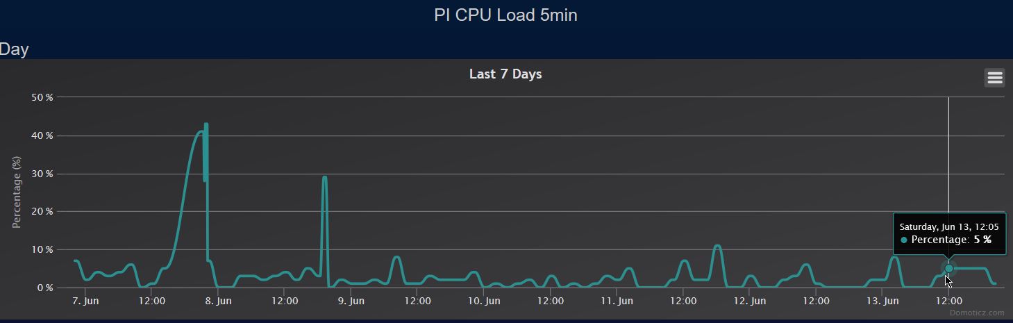

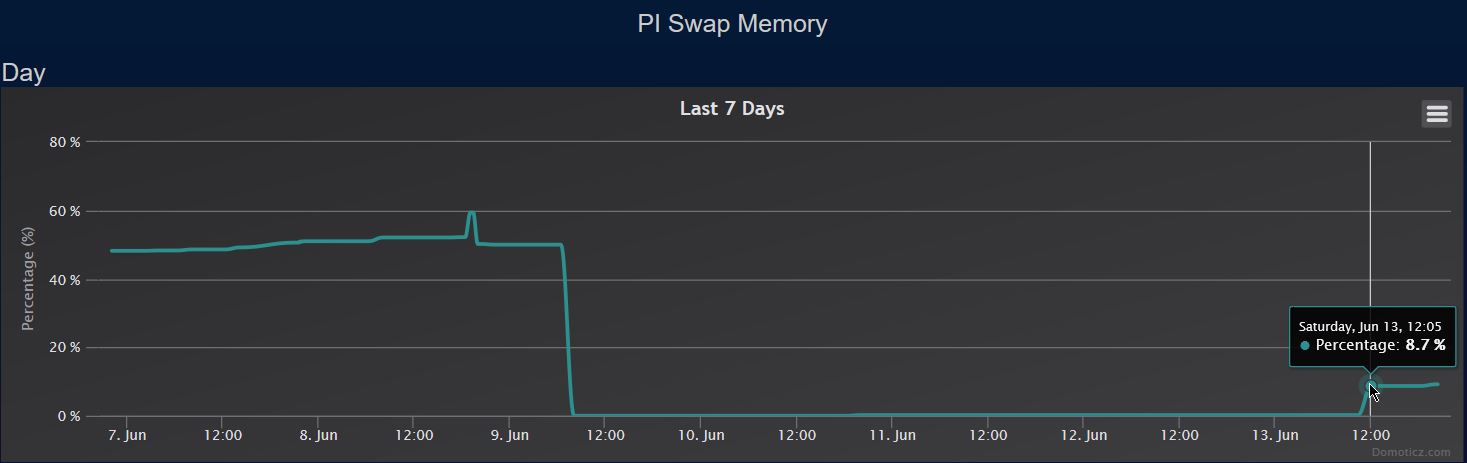

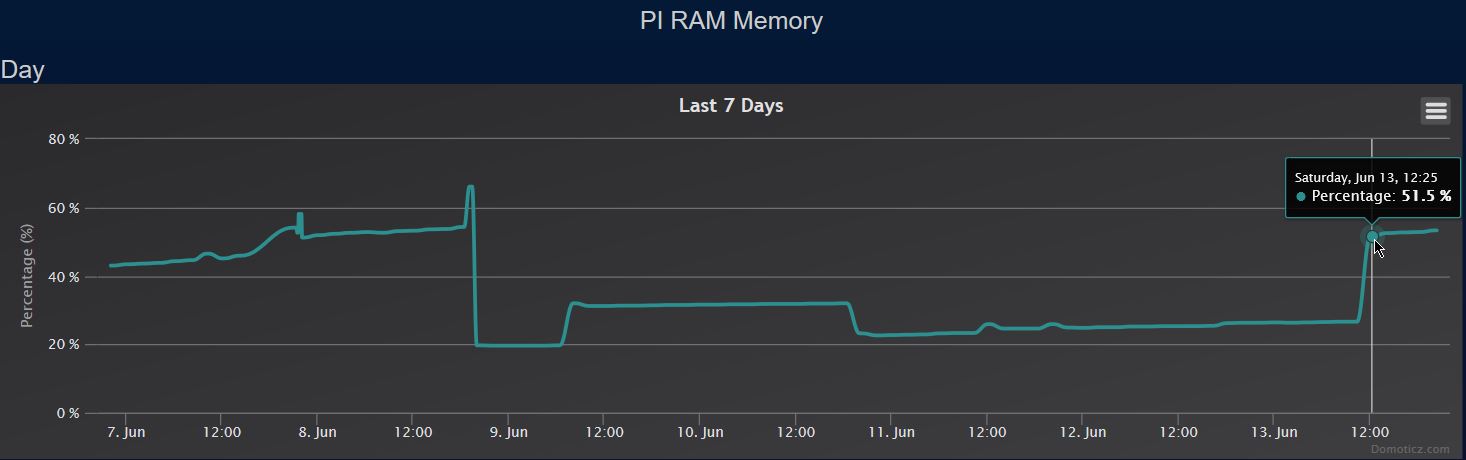

When MONIT once again warned about memory levels, RAM & SWAP Memory levels were greater than 55 % and increasing. I decided to close Firefox overnight to see if this changed the situation. In the morning, memory levels were lower. I tried Chrome browser but it turned-out to be another “Memory Hog”.
General RPI forums discuss about web browser memory leak issues and they recommend to limit the cache use (website history, cookies, etc). Other posts recommending OS commands to free-up cache memory. Please see attached bash script.
# 13/6/2020
# El Zorro
# Script meant to Clear Cache Memory
# If you are using firefox as web browser,open page about:memory and press Minimize memory usage
echo "Clear Cache Memory in Use"
# 1 Freeing Up the Page Cache
sudo sh -c "echo 1 > /proc/sys/vm/drop_caches"
# 2. Freeing Up the Dentries and Inodes
sudo sh -c  "echo 2 > /proc/sys/vm/drop_caches"
# 3. Freeing Up the Page Cache, Dentries and Inodes
sudo sh -c "echo 3 > /proc/sys/vm/drop_caches"
# 4. Flushing the File System Buffers
sync
Mozilla support posts ask users to login to about:memory page and click the "Minimize memory usage" button. There were other comments like add more memory to your PC or RAM usage of Firefox is normal to make it "faster". My guess is that these folks never used an HP 41CX in their lives and would balk at the thought of using a micro PC with 6 Kb RAM. Since RPI’s resources are limited compared to a desktop, a few Mb can make a big difference and one must be frugal with system resources.
Please see the system diagnostics trends below. The graph show the % SWAP Memory Usage; % RAM Memory Usage and CU Load 5min collected every two hours. Ignore data on the far left for it was collected during script testing and at faster intervals.
Without Firefox running, data on the far right show a plateau with RAM Memory around 26.5 %. Domoticz and all other applications do not appear to consume system resources. As Firefox was brought on-line, CPU Load is relatively the same; RAM Memory jump to 51.5 % and % SWAP Memory jumps to 8.7 %. Memory usage tends to increase slowly. My gut feeling is that RAM memory will eventually saturate. Please find two files with sorted process structure ( ps -auxf | sort -r -k 4 > psout) without and with the browser running.
Without Firefox
Process structure without Web Browser
Mem 240M/875M or 27 %
SWAP 512K/250M or 0.2 %
Average 5 Min CPLoad 10 %

With Firefox
Process structure with Web Browser running
Mem 446M/875M or 51 %
SWAP 21M/250M or 8 %
Average 5 Min CPLoad 28 %

% SWAP Memory
% RAM Memory
% CPU LOAD 5min
SWAP Memory 130620.jpg (46.77 KiB) Viewed 1913 times
RAM Memory 130620.jpg (46.77 KiB) Viewed 1913 times
CPU Load 5min.jpg (51.58 KiB) Viewed 1913 times
# echo "restart lxpanel"
# lxpanelctl restart old command
# Updated following Erem's recommendation from 12/12/2020
DISPLAY=":0.0" lxpanelctl restart 2>&1
sleep 5s
# echo "Clear Cache Memory in Use"
sleep 2s
sleep 2s
sleep 2s
sync
