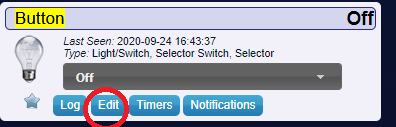

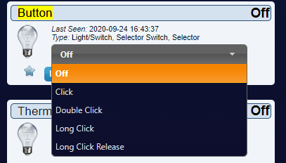

waaren wrote: Sunday 08 November 2020 19:52 I use the same button and on my system it is recognized as a selector type switch.
On the Devices lits appears as
- TYPE Light/Switch
- Subtype: Selector Switch
on the Switches TAB, it does recognize the different tap options:
on the Scene section, when the button is paired I see:
(It's here where I expected to be able to select the nunber of taps for THIS scene:
and for the code, I'll have a look at it, as I dont understand how it works, thanks!

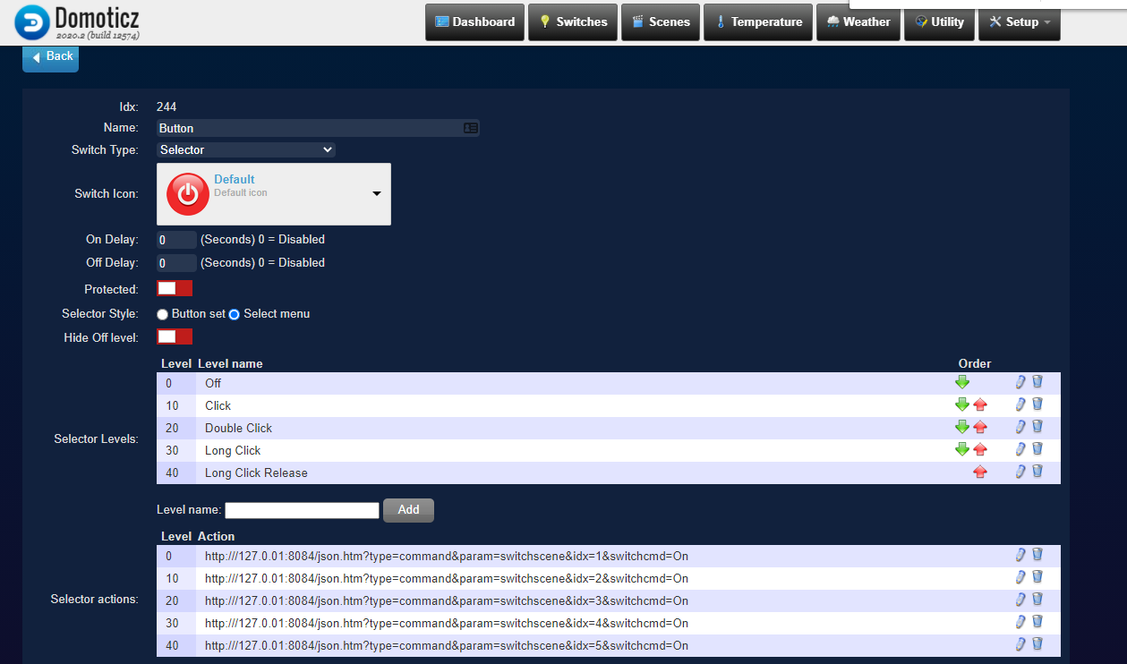

waaren wrote: Sunday 08 November 2020 19:52 At the edit screen of that switch you can add level actions like
http:///127.0.0.1:<domoticz port>/json.htm?type=command&param=switchscene&idx=<scene idx>&switchcmd=On
Re: SCENES issue: - Xiaomi double tap
soyelposeido wrote: Sunday 08 November 2020 20:29 on the Switches TAB, it does recognize the different tap options:
Mine look similar
now press edit on that switch
At the edit screen of the button set it like below (three ///) And set Local Networks (no username/password): on the settings page to allow 127.0.0.1
Selector Edit window.png (103.32 KiB) Viewed 371 times
