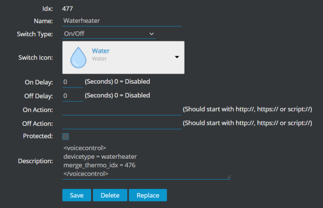

I have added first the devicetype to the switch used for the waterheater. And did a try to the thermostat used for the waterheater. Doesn't work.
DewGew
Posts: 581
Domoticz version: V4.10618
Location: Sweden
Re: Domoticz-Google-Assistant (dzga)
Post by DewGew »
fraisdos125 wrote: Monday 09 November 2020 21:04
DewGew wrote: Monday 09 November 2020 20:41
fraisdos125 wrote: Monday 09 November 2020 19:42
I went trough the post. There is something which is not clear for me. Is it only for a temperature range that it is not possible to set the set point to 60 (for instance) or for any thermostat ?
Temp range for heater, waterheater is set to 30 - 300. Is the device type shown as waterheater in device list?
Added this in the description:
<voicecontrol>
devicetype = waterheater
</voicecontrol>
but remains as heater in dzga.

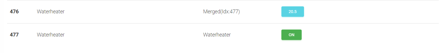

Create first a thermostat device (my case idx 476 called waterheater),
Then first a dummy device (my case idx 477 also called waterheater). In description add:
Device list in dzga will show:
Commands:
1 - Turn on waterheater!
2 - Set waterheater to 60 degrees!
3 - What temperature is waterheater set to?
4 - Turn off waterheater!
EDIT: There is no tuch control for heater, waterheater, kettle and oven. Only works with voice commands.

Post by fraisdos125 »
DewGew wrote: Friday 27 November 2020 17:02
fraisdos125 wrote: Wednesday 25 November 2020 20:59 Hello,
Not sure about the possible settings for waterheater. From the documentation:
//For heater/waterheater/kettle/oven devices only.
Function to merge thermostat device to control temperature. Merged device will automaticly hidden.
Bug Thermostat idx must be a number above Temp/selector idx.
<voicecontrol>
merge_thermo_idx = 123
</voicecontrol> \\
Does it mean we can add the options actual_temp_idx & selector_modes_idx to the waterheater ? Then we can set the thermostat to Heat or Eco modes ?
You can merge a thermostat to control temperature for those. Then you can merge selector modes and actual temperature to the thermostat.
Edit: modes may or may not work, I haven’t tested this with heater, oven, kettle or waterheater
Modes work ! There is only the point with temperature limited at 32°C when using the interface. With voice control I can set it to 60°C.
