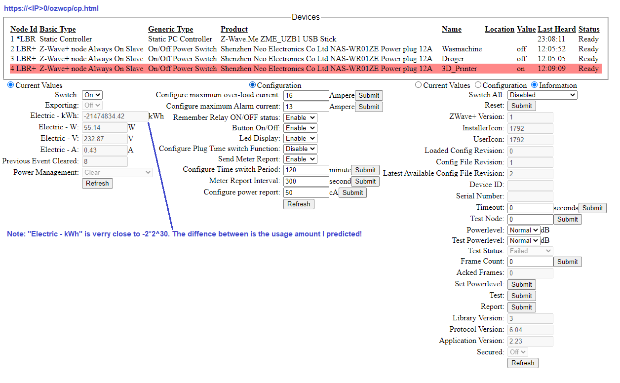

Random notes and thought process, TLDR below!
I just bought 3 'WR01ZE' modules, they have still reported some weird values
Day one 21474837,56 kWh (~1,120kWh expected, ~40+160+200+160+160+200+200)
Day two 21474838,4 kWh (~1.96kWh expected, ~40+120+200+160+200+120+??)
The reported values in Domoticz are awfully close to 2^30/2*100 (21474836,48kWh) So now I suspect the binary math somewhere is wrong (powers of 2, and a unit (k) mistake?)
So time to dig a little bit deeper: https://i.imgur.com/sZakxDI.png
The attached image shows that the "Electric - kWh:" reported value (I guess it's a raw value in DEC) is negative a lot and is really close to -2^31.
A signed 32bit integer has a range from -2147483648 to 2147483647 (-2^31 to 2^31-1).

ERROR:
Where 'x' is the value in 'Week' stats of a day in Domotics "IP/#/Devices/57/Log" log
Where 'y' is the value of 'RAW: Electric kWh' in 'IP/ozwcp/cp.html -> Current Values'
kWh since start = x-(2/100*2^30)
y = (x*-100)
