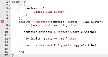

Only just started with dzVents, have something very simple running to toggle the state of a switch every 15mins, now I would like to use my dual zigbee wireless switch to toggle the state of a lamp on each press, I have this
2020-11-03 20_30_05-Domoticz Home.jpg (18.36 KiB) Viewed 525 times
But I get this error repeating in the log which I don't understand,
2020-11-03 20:25:24.253 Error: dzVents: Error: (3.0.2) error loading module 'Zigbee - Dual' from file '/home/pi/domoticz/scripts/dzVents/generated_scripts/Zigbee - Dual.lua':
2020-11-03 20:25:24.253 ...ticz/scripts/dzVents/generated_scripts/Zigbee - Dual.lua:7: ')' expected near '-'
TIA
Dave

There is - between Zigbee - Dual and not in line 4
Or the spaces between the words
Maybe this is the problem

I removed the - because I thought it might be an issue, I've correct my mistake, now the log says
2020-11-03 20:54:09.570 Error: dzVents: Error: (3.0.2) error loading module 'Zigbee Dual Switch' from file '/home/pi/domoticz/scripts/dzVents/generated_scripts/Zigbee Dual Switch.lua':
2020-11-03 20:54:09.570 ...scripts/dzVents/generated_scripts/Zigbee Dual Switch.lua:7: ')' expected near 'Dual'

And the spaces between “Zigbee Dual Switch”

Dave21w wrote: Tuesday 03 November 2020 21:34 I get this error repeating in the log which I don't understand,
If you share code or logs please post as text between code tags (it will make it easier to test and correct). Also if you are in develop / test phase it helps to set the script logging to domoticz.LOG_DEBUG
It could give you just enough extra information to help you find an issue that would otherwise might remain unseen.
In your script you refer to switch but you pass another object as second parameter in the execute function.
An if block need to be closed by an end
if <condition(s)> then
<action(s)>
Can you try this
return
    on =
        devices =
            'Zigbee Dual Switch',
    logging =
        level = domoticz.LOG_DEBUG, -- set to domoticz.LOG_ERROR when all OK
        marker = 'Zigbee toggle' ,
    execute = function(dz, item)
        if item.state == 'B1' then
            dz.devices('L Zigbee').toggleSwitch()
        elseif item.state == 'B2' then
            dz.devices('R Zigbee').toggleSwitch()

Also just a beginner but I think it will work if you replace the function to :
function(domoticz, item) or function(domoticz, devices)

Thanks for your reply waaren, I now have the error log below, please don't think I'm being rude but what do you mean by "between code tags"
2020-11-03 21:09:00.182 Error: dzVents: Error: (3.0.2) error loading module 'Zigbee Dual Switch' from file '/home/pi/domoticz/scripts/dzVents/generated_scripts/Zigbee Dual Switch.lua':
2020-11-03 21:09:00.182 ...scripts/dzVents/generated_scripts/Zigbee Dual Switch.lua:14: '}' expected (to close '{' at line 12) near 'toggle'

Corrected by adding quotes around the marker string. This should do it
return
    on =
        devices =
    logging =

Hi waaren, your script works a treat thank you, I will try and absorbe this information and not ask so many stupid questions in future (no promises though :D )
