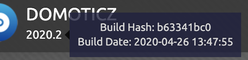

I've a Raspberry Pi 4 with indeed a powered USB hub in which the Aeon Z-Ware stick is inserted. I've about 24 Fibaro Z-Wave devices connected and 2 Qubino. The Domoticz version is:
Screenshot 2021-01-15 at 14.14.47.png (48.86 KiB) Viewed 3013 times
The OpenZWave USB Version is: 1.6-1033-g3661f170. And I've to say, I do not have any problems, it is a stable working solution for the last 6 month.
