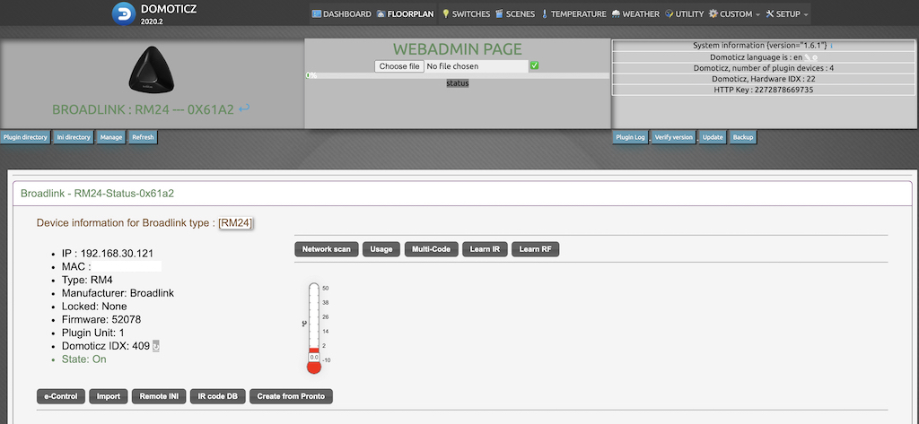

Hello, I am trying to have my RM4 Pro working but have some problems with RF (IR works good).
If I try to do the sweep, all go ok and switch to Learn correctly.
After a couple of secs, without doing anything the Learn process stop giving an error:
State: Error to learn RF code
Error: (Broadlink) ERR : learnrf--RF not true, sweep necessary--21
If I try the same using the CLI interface, the RF remote is correctly sweeped and learned.
What can I check for errors?
Thank you
Chris

chrispazz
Posts: 81
Joined: Friday 08 July 2016 10:38
Re: Python Plugin : Broadlink
Post by chrispazz »
Yes, it keeps the frequency since the Learn button switch on by itself but if I press Learn, after 2 secs it get off without any interaction and with the given error.
Which kind of log can I see to diagnose the problem?
Thank you

zak45
Posts: 954
Domoticz version: V2024.4
Post by zak45 »
Can you provide the same log, but after a sweep ?
and also a screen shot of your device configuration
