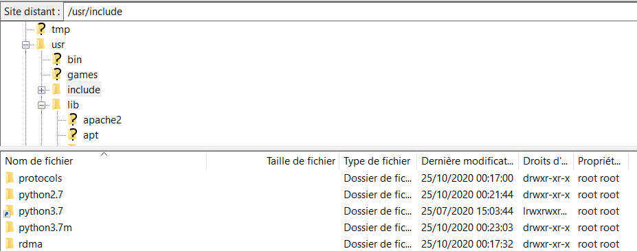

The command line "cmake -DCMAKE_BUILD_TYPE=Release CMakeLists.txt" found the python3 include file at /usr/include/python3.5m.
However the os ugrade from Stretch to Buster upgraded also at the same time python3 from python3.5 to python3.7 as shown in the attached screen capture.
Screen Capture /usr/include directory
ScreenCapture 2020-10-26 223803.png (28.51 KiB) Viewed 2515 times
So I do not understand how the command line "cmake -DCMAKE_BUILD_TYPE=Release CMakeLists.txt" found the python3 include file at /usr/include/python3.5m which does not exist any longer.
I would be grateful if you could advise me on the way to proceed.

Re: Version CURL_OPENSSL_3 not found when upgrading the os from Stretch to Buster
meal wrote: Monday 26 October 2020 23:07 I have performed the build of domoticz according to "https://www.domoticz.com/wiki/Build_Dom ... rom_source"
First cd /home/pi/DEV20200309/domoticz
I tested the installation process wiki on an Intel NUC and on a Raspberry (both buster) and it works without issues on both.
Did you also managed to do the steps before the git clone successfully ?
sudo apt-get install make ....
get and install cmake 3.16 or newer
get and install boost
etc..

I have installed python3.5 via "sudo apt-get install python3.5-dev"
and went through the domoticz build process successfully .

meal wrote: Wednesday 28 October 2020 2:59 I have installed python3.5 via "sudo apt-get install python3.5-dev"
According to the wiki you should have done
sudo apt-get install make gcc g++ libssl-dev git libcurl4-gnutls-dev libusb-dev python3-dev zlib1g-dev libcereal-dev liblua5.3-dev uthash-dev
This would install the latest version of python3-dev (3.7.3-1 on buster or 3.8.2-3 on bullseye)
