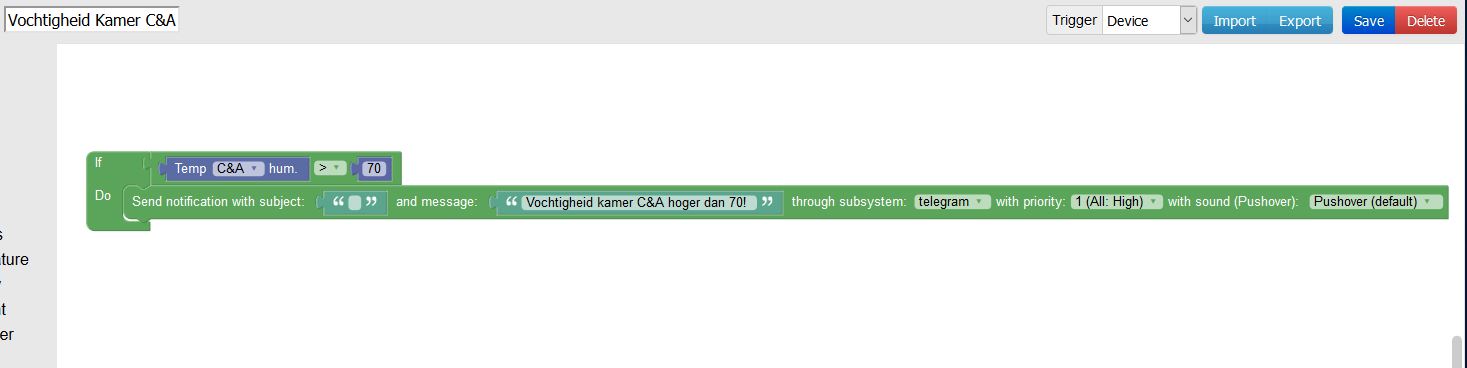

I've made a script that sends me a message when the humidity in one of my rooms is too high.
The problem I'm having is that I'm now recieving a message every minute...
How do I manage to send me to only send 1 message? I will change the script so I get 1 when it's too high and one when its back ok..

This would require some LUA/DzEvents scripting. I would either use an extra UserVariable or Persistent variable.
Then when the "Luchtvochtigheid" gets above 70, Check voor de value of the UserVariable and when it isn't 1, Send the Telegram message and set the UserVarible to 1.
When the "Luchtvochtigheid" gets below 70, reset the UserVariable back to 0, so the next time it gets above 70, the same process is triggered.

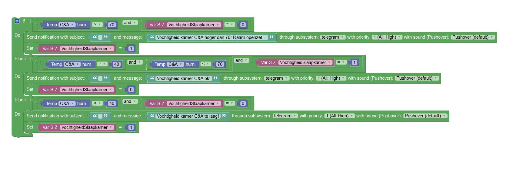

- Posts: 15
- Joined: Friday 09 October 2020 9:05
Re: Let script only send telegram message once
So far so good!
