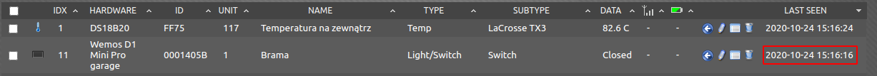

database as well as API contain valid values:
sqlite3 domoticz.db  "select name, id, lastUpdate from devicestatus where name is 'Brama' "
Brama|11|2020-10-24 18:06:54
curl -s 'http://<domoticz-ip>:8080/json.htm?type=devices&rid=11' | grep Last
                        "LastUpdate" : "2020-10-24 18:04:58",
I looked at the logs for 'Brama' and saw that what dzVents reports as a lastUpdate is actually the time when the device state changed:
2020-10-22 18:55:20	Closed	Admin
2020-10-22 18:52:38	Open	Admin
I'm afraid there is something wrong with my domoticz :(. I've added another line to my script to test another device, as you requested. But logs doesn't show another log line. I've tried with different IDXes (not only 10) - same result.

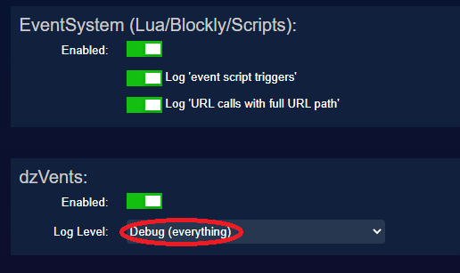

Could you set dzvents Log Level to Debug(everything) via the buttons [setup] [settings] [other]
like below. You will get a domoticzData.lua file in <domoticz dir>/scripts/dzVents/ directory with all data dzVents receive from domoticz. Search for the device giving the wrong lastUpdate time.

Here's what I got after setting log level to debug:
