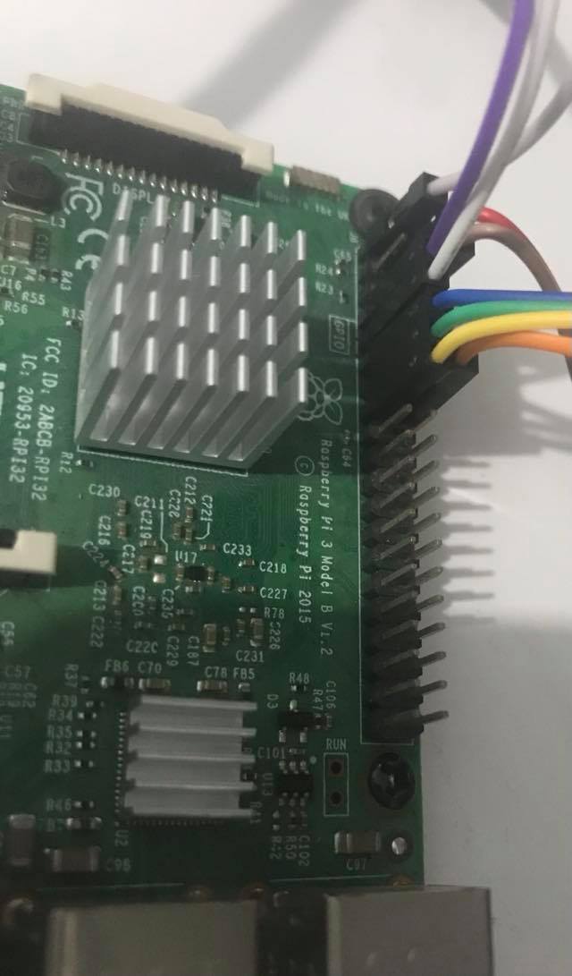

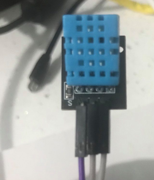

ok,sorry for poor details,i use raspberry pi 3,and last version of domoticz,i succeed to conect and setup 4 5v relays and i need to add this sensor.
this is my conections:
vcc- +3,3v
gnd
signal - pin7
vcc- +3,3v
gnd
signal - pin7
- 2.jpg (36.16 KiB) Viewed 2684 times
- 1.jpg (53.58 KiB) Viewed 2684 times

@arhangel76 ,
There are a few options/path you can look at. It does not work straight out of the box without doing anything.
There are a few 'hardware' modules to try:
- 1-Wire (System)
- generic sysgpio
- I2C sensors
- Raspberry GPIO sensors
Your sensor is not an I2C sensor and as far as I know not a (Dallas) 1-Wire compatible sensor, so I would guess to start with GPIO.
I know that I have a few sensor on my raspberry (the one that runs Domoticz) through a HAT board (Automation HAT) where Domoticz reads the data using the 'generic sysgpio' module. But therefor I have to 'configure' sysfs GPIO (tell which gpio pins have which function) at boot before starting Domoticz.
From the sourcecode of the 'Raspberry GPIO sensors': (Maybe start here?)
