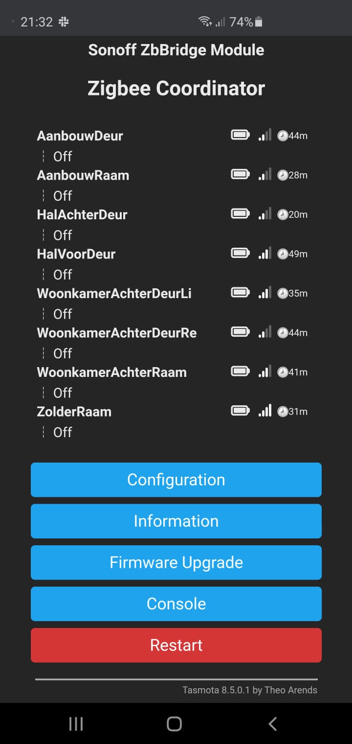

Posts: 1302
Domoticz version: 2024.4
Re: Pass2PHP
Post by sincze »
ropske wrote: Wednesday 21 October 2020 9:21 @Egrerius, i read that you also use some Xiaomi product. What controller you use for them?
Xiaomi Gateway in use and Sonoff Zigbee Gateway with Tasmota.
Pass2php
USB: RFXCom, ZWave, Sonoff 3
MQTT: ZIgbee2MQTT,
ZWAVE: Zwave-JS-UI
Solar: Omnik, PVOutput
Sensors: You name it I got 1.
