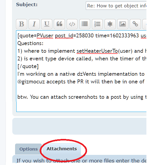

btw. You can attach screenshots to a post by clicking the Attachments button below your edit window and choose 'add files'
