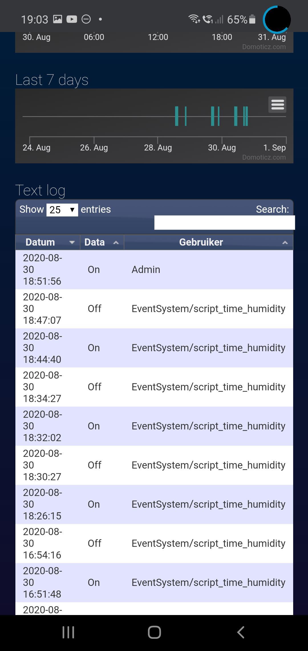

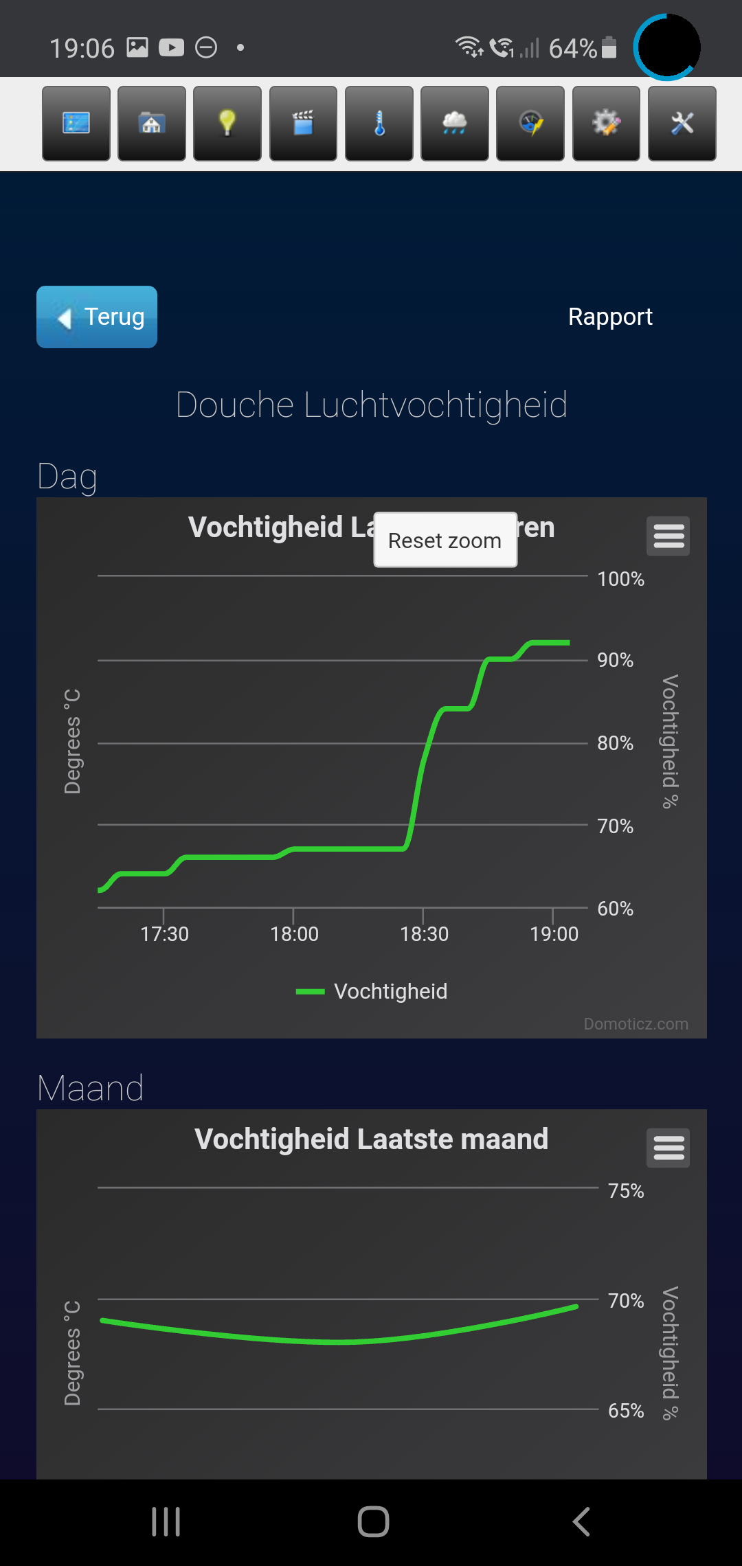

Re: Lua script for controlling humidity in the bathroom
I tried to control the bathroom fan with Blockly and it just doesn't work. This script works though the fan is turning off way too soon.
I just took a shower and after 2 minutes the fan came on. Then little over 2 minutes later it turned off.
After me my wife went to the shower and the same thing happened, on and 2 minutes later off.
I checked the humidity sensor and it was 92%, is the script not working, did I do something wrong or can I add a backup somewhere that when humidity is above 80% it stays on?
Thanks,
Thanks,
- Screenshot_20200830-190641_Chrome.png (376.8 KiB) Viewed 12295 times
- Screenshot_20200830-190342_Chrome.png (360.21 KiB) Viewed 12295 times
