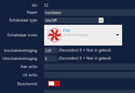

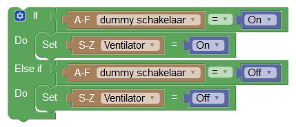

Post by Treve »
Set the delay of 2 minutes
The second set (Ventilator = off) stops the timer of the Fan
This is working at my Domoticz 2020.2
