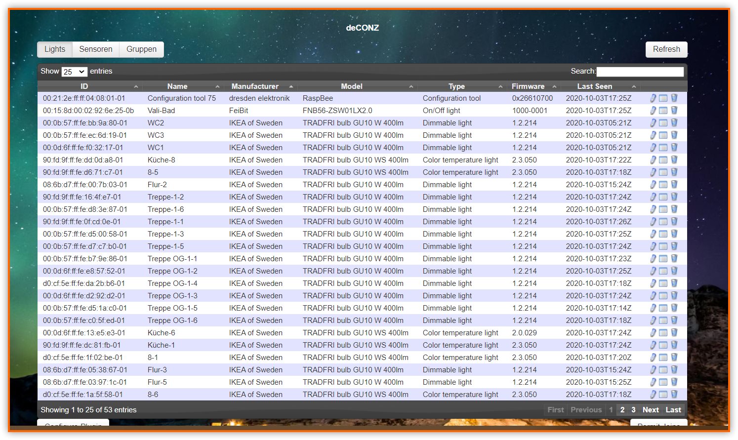

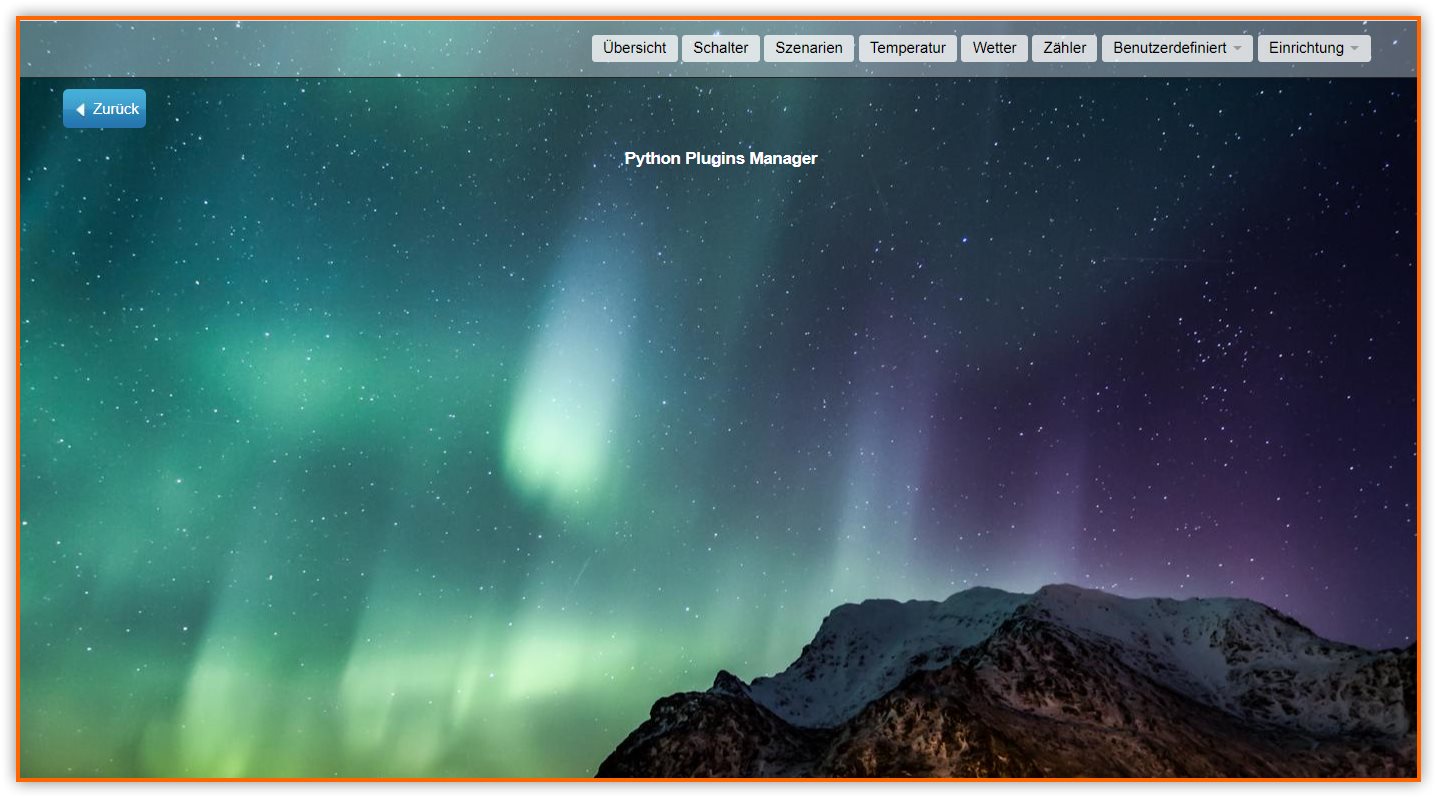

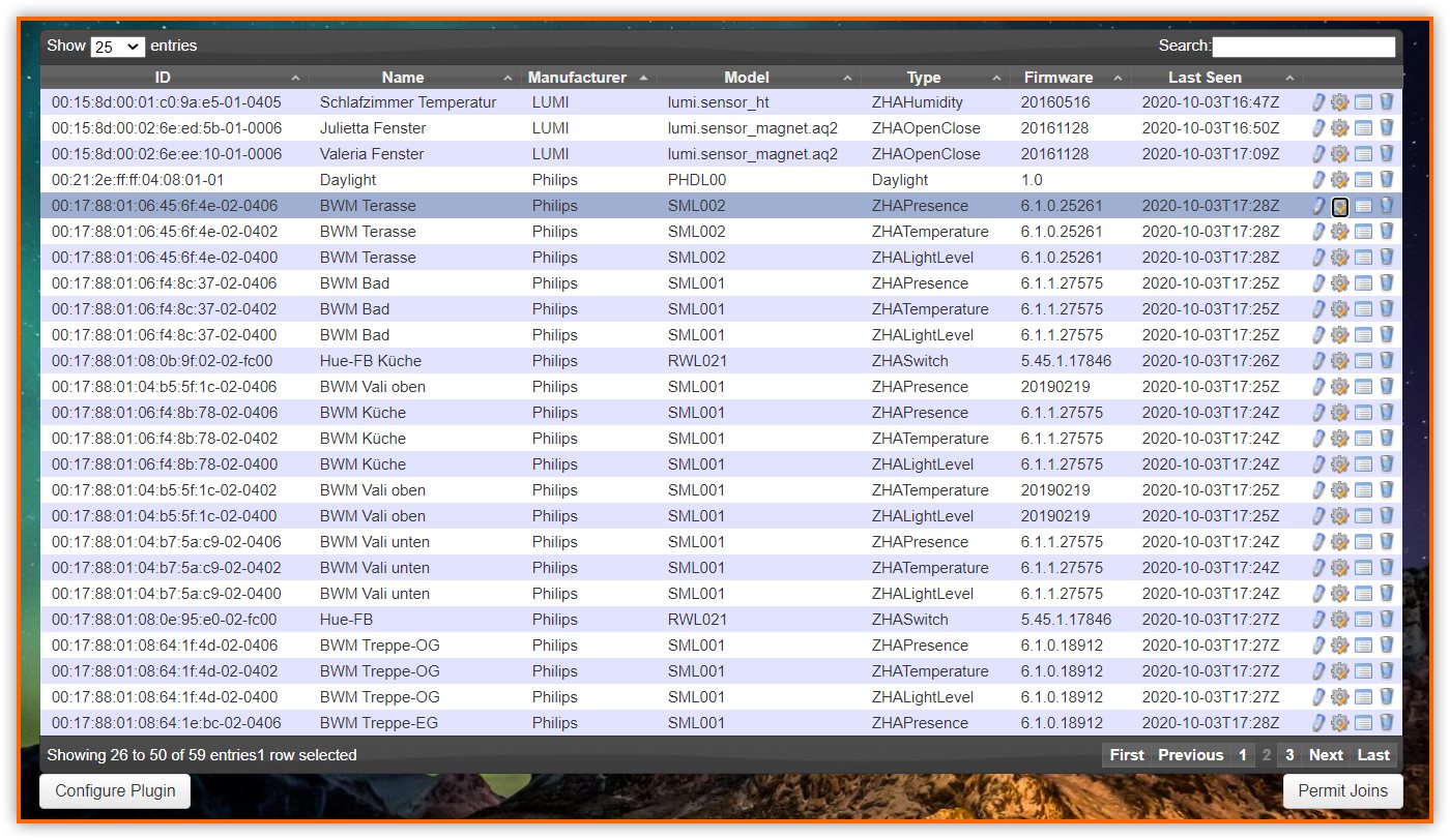

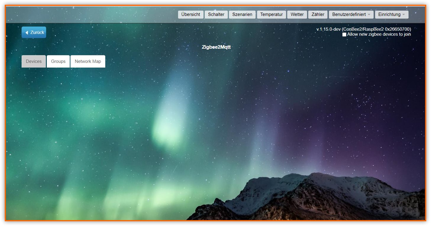

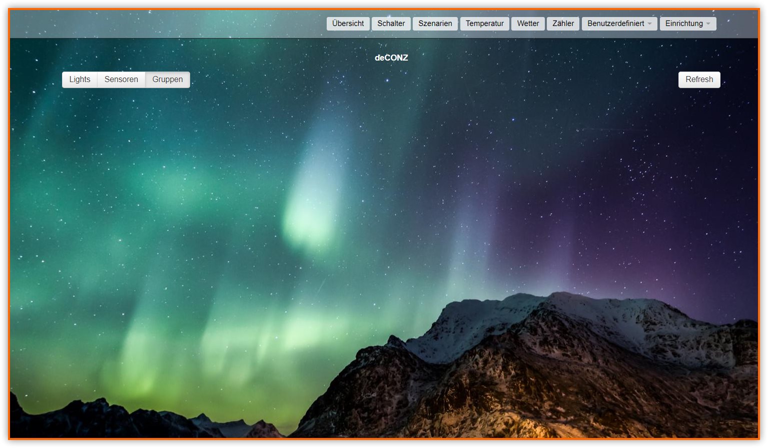

salopette
- Posts: 187
- Joined: Tuesday 07 March 2017 21:03
- Domoticz version: BETA
- Location: Germany
Re: Python Zigbee plugin, deCONZ bridge (Using Conbee or Raspbee)
Wow your Deconz is working now!
But not the others yet
I have to wait until gizmocuz fixes the error.
No page is built!

Thorgal789
- Posts: 876
- Joined: Wednesday 15 August 2018 14:38
- Target OS: -
Nice thx a lot ^^. I think it was the bug corrected the faster ^^.
